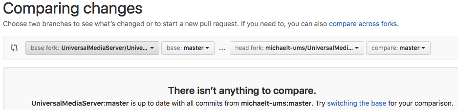

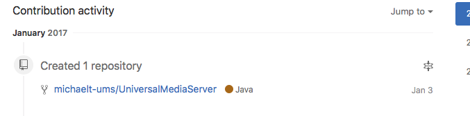

Got through the changes, testing, commit & push.
How do I tell if the NB push worked?
Now stuck on GitHub pull request.
Pictures better/faster than words.

Tried different base/head/fork/compare combos - nothing.
This is not intuitive.
What am I doing wrong?

The NB push didn't work/the changes are not pushed to https://github.com/michaelt-ums/UniversalMediaServer

As long as you haven't entered your github credentials anywhere in NB, I can guarantee you that no push has been performed. You don't have write permission to your GitHub fork without them.

Found the problem: "Push" sb "Push to Upstream"
PR posted & waiting.
