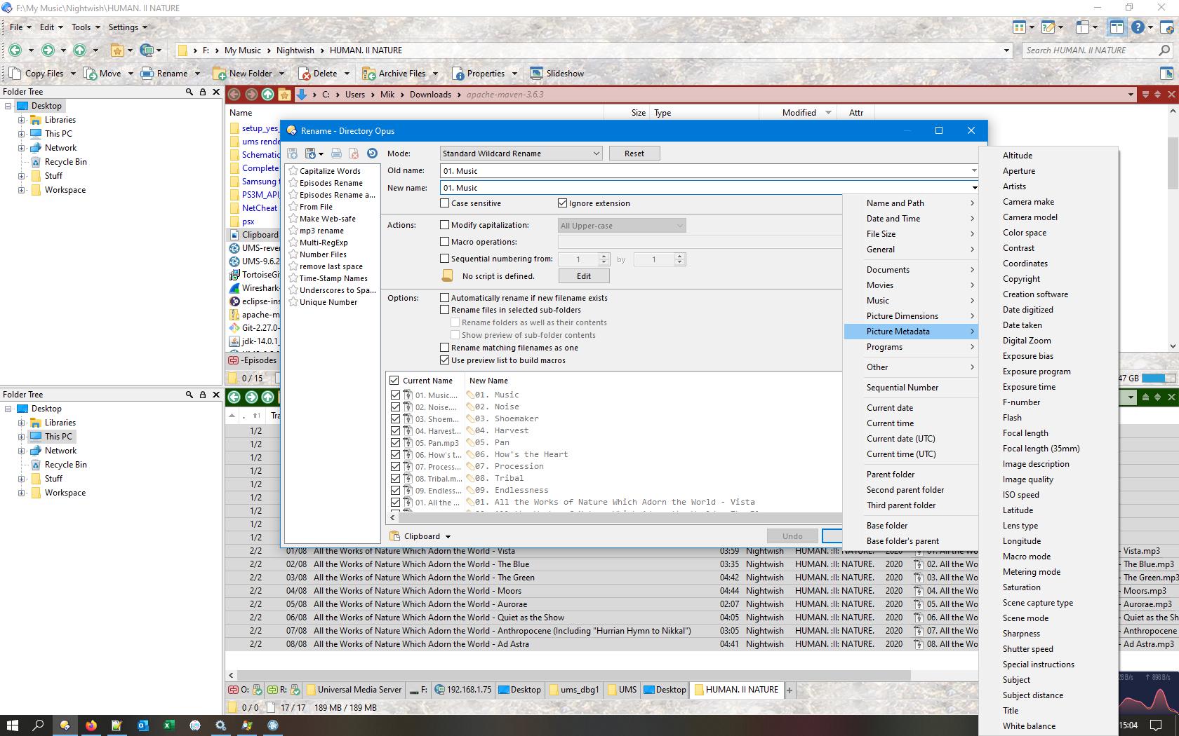

Re: About the transfer to and the use of metadata (all media) by the renderers
I think I understand what it is you are looking for.
using the example for mp3
if you have your files all mixed together in a directory with unhelpful filenames like
Most players can extract the tags like Track number, Title, Artist, Album, Year and display that instead of the file names
but those that can't you are left with this mess. A work around it to rename the files using the tags to something like
as Nadahar says there is no support for similar tags in the protocols and most players for images so the workaround is to do the renaming on the PC side, but I don't think that is something UMS could do and probably difficult to automate something in windows explorer.
My suggestion is try Directory Opus, Something I cannot live without. It can be run to replace explorer and can do many things that are too long to list here.
But one of it's features is very powerful renaming tool which is able to take the metadata to make better meaningful filenames and scripts that can automate repetitive tasks It is not free though but has a 60 day trial, but is worth the price if you want to stick with it. It is one of the few pieces of software that have actually made me want to part with my money
Nightwish - Endless Forms Most Beautiful(2015) - 01 Shudder Before the Beautiful.mp3
Nightwish - Endless Forms Most Beautiful(2015) - 02 Weak Fantasy.mp3
Nightwish - Endless Forms Most Beautiful(2015) - 03 Élan.mp3
Nightwish - Endless Forms Most Beautiful(2015) - 04 Yours Is an Empty Hope.mp3
Nightwish - Endless Forms Most Beautiful(2015) - 05 Our Decades in the Sun.mp3
Nightwish - Endless Forms Most Beautiful(2015) - 06 My Walden.mp3
Nightwish - Endless Forms Most Beautiful(2015) - 07 Endless Forms Most Beautiful.mp3
Nightwish - Endless Forms Most Beautiful(2015) - 08 Edema Ruh.mp3
Nightwish - Endless Forms Most Beautiful(2015) - 09 Alpenglow.mp3
Nightwish - Endless Forms Most Beautiful(2015) - 10 The Eyes of Sharbat Gula.mp3
Nightwish - Endless Forms Most Beautiful(2015) - 11 The Greatest Show on Earth.mp3
Nightwish - HUMAN. II NATURE.(2020) - 01. Music.mp3
Nightwish - HUMAN. II NATURE.(2020) - 02. Noise.mp3
Nightwish - HUMAN. II NATURE.(2020) - 03. Shoemaker.mp3
Nightwish - HUMAN. II NATURE.(2020) - 04. Harvest.mp3
Nightwish - HUMAN. II NATURE.(2020) - 05. Pan.mp3
Nightwish - HUMAN. II NATURE.(2020) - 06. How's the Heart.mp3
Nightwish - HUMAN. II NATURE.(2020) - 07. Procession.mp3
Nightwish - HUMAN. II NATURE.(2020) - 08. Tribal.mp3
Nightwish - HUMAN. II NATURE.(2020) - 09. Endlessness.mp3

The case of VLC is that there is a panel to display metadata into "tools" on right-click on an image, but the content is empty and there is no documentation at all.
For KODI there is more documentation but I have not found the required, I must send a message.
It is sure that I must go in these questions with the others involved actors of the process.
For UMS the basic question was : does UMS changes anything of the EXIF and IPTC data of images (note that I have to look at the video and sound records also) ?
After, the question is why renderers don't take in account simply the most common IPTC data like "the title" to display (even a title is defined in IPTC and EXIF VLC displays the filename with label "title").
One consequence of the fact that the "title" of an image cannot be displayed under the image by renderers but most of time a field named "title" containing the filename is that someones have developed software to rename the files with a title built from metadata extracted from EXIF and IPTC !!! (the problem is that this operation is not reversible for mental and you cannot get the filename back if you have not created a reverse conversion table, a no-solution for libraries management).
I think that sometimes technology development leads to stupid situations (why by simple if we can find very complicated solution : the advantage : create occupation).
I agree about the fact that the center of the subject concerns more renderers than servers, but not entirely on renderers because they are both involved because of the needed continuity of solutions. Authors (concept and development) of servers and renderers should collaborate (the case of the reencoded images for example) even the center of the work is nearer from the developers of renderers, no solution without concertation with the developers of servers. The question is "where", it is not pure DLNA or UpNp it is "metadata creation, transmission and rendering".
I am going to begin with this last subject to build questions to VLC and KODI (may be you can suggest others open renderers). I have found on their forum and wiki several question on this subject.
The reality is not so black. In fact everything looks like, while a standard is existing since long years (for EXIF, IPTC and XMP) the development of renderers has not taken in account the minimum elements. Renderers developers seems to have taken in account the need of displaying titles and comments of images, author (fields placed info display panels for example, because it is stupid to display a image without a title) etc. but this regardless to standards and have not developed the connector. The fields remaining empty.
This lead that VLC fill a field names "title" with the filename. This could be the default if the title is not defined into EXIF and/or IPTC-XMP metadata.
For KODI it is more developed. The displays are based on XML which uses the media object (current pointed into a list or current viewed) and metadata libel1 and libel2 can be displayed (seen in xml description of display). For now I I had no time to go to the code to know how these data are filled and from where, if they are. All of this comes from the same needs, developers have planed a display but the connection with the data which can be easily filled into the source media objects (using xnView for example) has not be done but it is ready (may be in Kodi just some lines of code are missing : using the existing library to extract the right metadata from the object and then fill the corresponding data items). Nevertheless the wiki of KODI is well done (but not very active) and could be considered as on the way of the level of the Codex or Wordpress. Note that the XML pages used for rendering can be easily adapted.

The first and most important thing is that the metadata of all type are currently weared by the media objects. If the user has added (filled) the metadata they are transmitted with the object (I say the user, I should say the user who have to fill data as description, author and title etc., while a lot of metadata are filled by the equipment used to get the media, everything is ready to use it. The user can use a lot of products to manage media (for images particularly products as xnView), but in fact each hardware producer - media production - Canon, Nikon, Sony, Olympus, Panasonic & co have defined their own exif metadata, IPTC metadata and now finally the EXF - XML - "exotic" metadata, used by their own tools that they propose to manage technically the media (mainly for professionals) but there is a common core containing the same data for "titles, descriptions and technic ref as GPS data etc... KODI offers the show on a map where the images have been generated if GPS data have been filled... but unable to display the title of the image...). All of this can be found here : https://www.exiv2.org/metadata.html and https://www.exiv2.org/tags.html and https://iptc.org/standards/photo-metada ... -standard/ and XML the extension of IPTC the XMP record. This for images but we can found same standards (with a same core) for video and sound (not so developed).
All users can use the metadata to create for the documentation of libraries, and create the content of libraries by filtering these data that are included into the object.
For development of software built to manage these data, store, extract there are soft-libraries which makes the job easy (I have some references).
The current problem is that all these data cannot be used (are not) into display of lists of media and the "info" about a media by the renderers. the chain is not completed. Some bridges have to be developed for the user becoming able to define the display of these (his chosen) metadata. Really for example, define is own zone to display metadata by the render. The reason of the feasibility is that tools to define, build XML/HTML code to display an information zone and at the other end of the chain to display the content for a particular item, these tools are existing and it is easy to implement... Inserting the "scripting" into XMP data and the renderer displays the content, this need only a name for the field, name used by everybody.
Note that for servers, the lonely problem is with the EXIF data when there is a transcode. The module which writes the exif data used by the renderer must write both the new image parameters and too the full remaining (not changed) metadata blocks.
