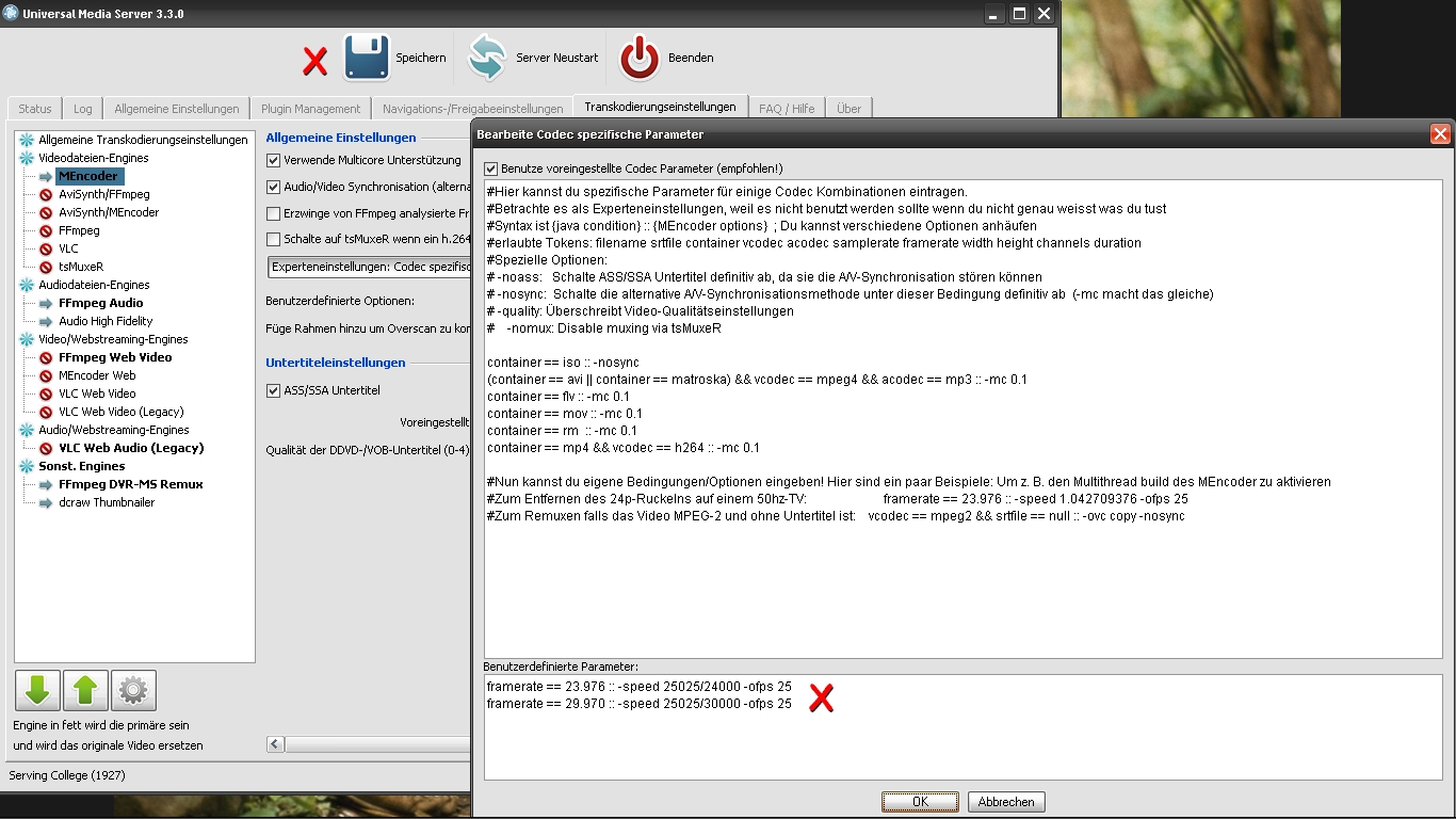

Hi again,
some minutes ago i found a solution for the (my) NTSC framerate problem.
NTSC videos with 23.976 or 29.970 fps causes audio disturbance transcoding to my PAL device which uses 25 fps.
Inside UMS select Transcode settings Tab and select MEncoder.
Click Expert settings and insert this code in the box:
framerate == 23.976 :: -speed 25025/24000 -ofps 25
framerate == 29.970 :: -speed 25025/30000 -ofps 25
Don't forget to save. Restart UMS and enjoy.
Regards
