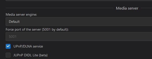

There is a setting I have not seen before in your UMS.conf file and I believe it is related to a switch in one of the networking dependencies.
Looking in the web settings it is "JUPnP DIDL Lite (beta)" and as this is a beta it could be buggy.
Try and turn this off and see if this fixes it.

Turned off, no, if only it was this setting for now.... Seems to be very strange.
