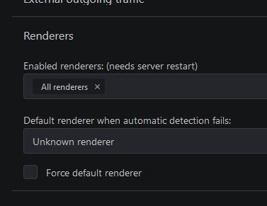

The conf might have to be tweaked a little to remove that as a supported format so that UMS can automatically transcode those, but there was no conf included in your logs as it was set to force default as @boss mentioned. (this also explains the unknown renderer for your computer)
Make sure Force default renderer is off so your TV can be detected correctly and the right conf used. I think the right conf to use might be the Samsung-UHD-2019.conf one and that does not have DTS as a supported format.
See what one is used when not forced and if it does not use the right one then I can make some tweaks for you if you do some more logs.

Many thanks for your reply. force default renderer is deselected. I have 3 TV's:
Samsung Q70 (QE65Q70TATXZG) which is working good
Samsung Q80 (QE65Q85RATXZG) which is not working
Samsung Q90 (QE65Q95TATXZG) which is not working.
I have attached the configs of all tree models. It seems that the Q80 and Q90 uses the same config. i renamed one of the file with _q80 for uploading it here. But both uses the Samsung-UKG-2019.conf.

Yes, the samsung-q9.conf is set to the originally one.
How to i check that the mkv dts files are played) should i enable force default render?
