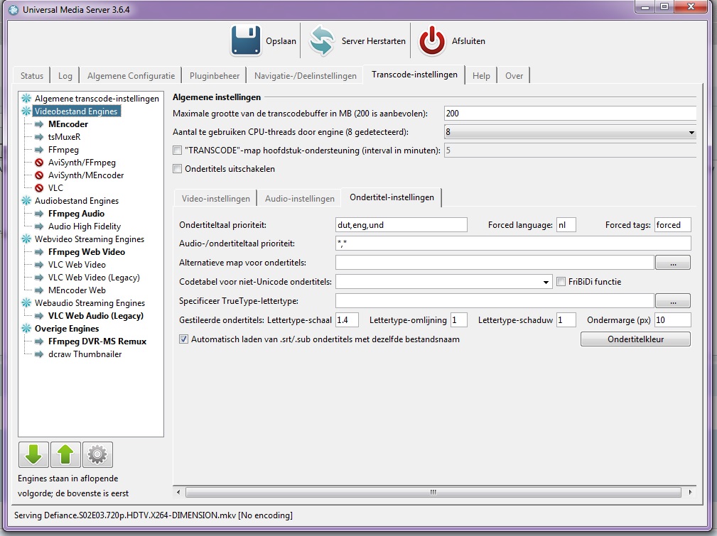

I have attached the debug log and a screenshot of the settings, maybe I have something wrong there (everything is the same as in PS3MS)
Thanks again!
- settings screenshot
- UMS.jpg (201.04 KiB) Viewed 15169 times
