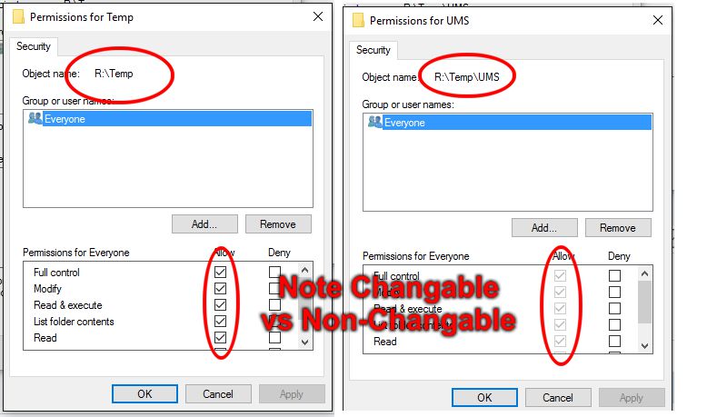

Permissions attachedNadahar wrote:I don't have the full overview of what the temp folder is used for, but transcoding is a major part of it so moving it somewhere else probably isn't that interesting. What does the permissions on R:\temp\UMS say then?
ALL Drives on both systems are NTFS, and yeah, I can do whatever I want in the generated UMS folder.
- UMS.jpg (70.37 KiB) Viewed 10015 times
Re: UMS won't launch
Yes, the reason it's non changable is because it's inherited from the parent folder. I just have to figure out why the permissions are read wrong. I know it usually works fine on Windows 10, so what is different in this case?
