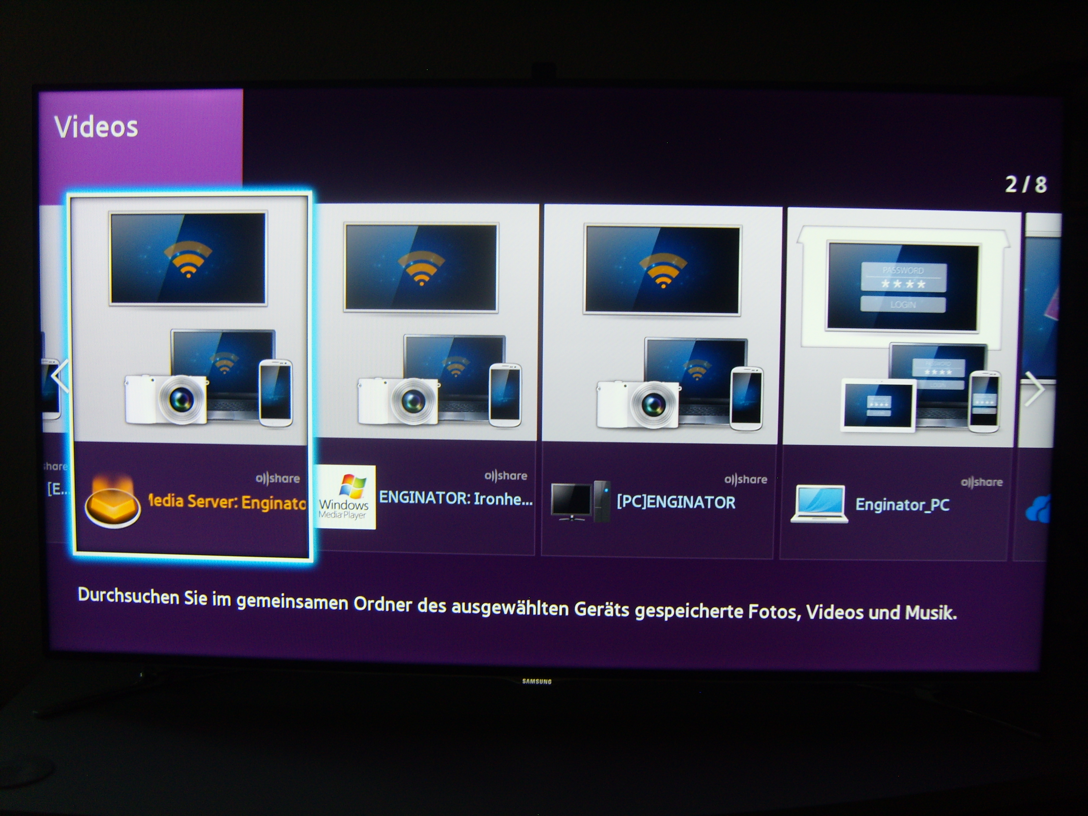

Hello everybody
I have a Samsung ue40f8080, but none of the configuration files seems to work, because I can not see the server on the TV.
I can still see the old PS3 Media Server, but actually my server was supposed to be called UMS.
Does anyone have suggestions on what I need to change?
Sorry for the English, I'm Swiss.

Re: Help us improve support for your devices
hi, try switching the ports for ps3 and ums, they can't co-exist on the same port.Ironheart1972 wrote:Hello everybody
Also check that your computer's firewall is open on both ports.
