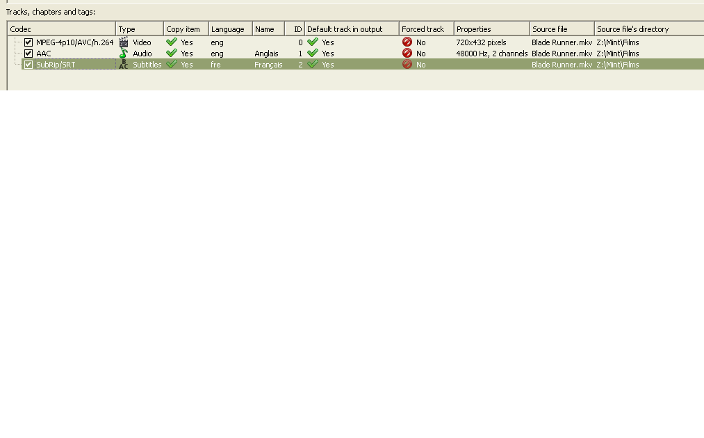

and I have the same issue : the image is stretched and no subtitle. The file is a MKV file with Embedded subtitle. It plays fine with vlc. I have checked with mkvmerge and I don't see any issue:
See attached.
I also tried to set the subtitle as "forced" with mkvmerge but it has not changed anything.

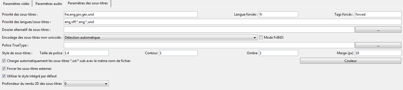

I have also attached the UMS subtitle configuration.
See attached.
I have only 1 MKV file with Embedded subtitle, so I cannot compare.

And you are editing the correct .conf? (it's Sony-Bravia5500.conf , not Sony-BraviaW.conf)

About subtitles, eng, off; means; if the spoken language is english language then show no subtitles. Is that what you want?
Could be you should set it to
personally I would remove the
Have you tried the config I attached in my first post?
fre,off;*,fre;*,eng;*,und

OMG, you are right, the clean install has also reset the subtitles settings.
As suggested, I have changed them with and the subtitles have reappeared.
