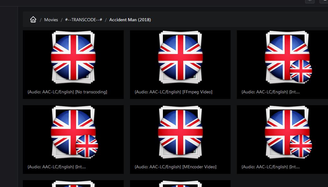

Like in these pics.
2nd pic is the one you will see first and top pic is the one you will second.
- transcode 2.JPG (82.68 KiB) Viewed 5437 times
- transcode 1.JPG (30.09 KiB) Viewed 5437 times

When transcoding it is only possible to have one audio track and subtitles have to be burnt in to the video so the #--TRANSCODING-=# folder lists all possibilities of audio track, subtitle and transcoding engine, which can quickly add up if your video has many subtitles and audio tracks.

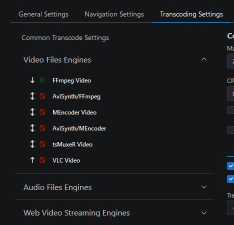

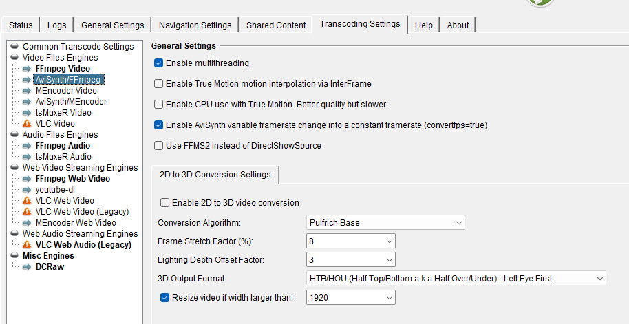

If the number of options get overwhelming when using it, you can turn off all but one of the transcoding engines (I recommend using FFmepg). Once the conf is correctly set up and you have the audio and subtitle language set to what you want then all this will be done automatically without needing to use the #--TRANSCODE--# folder

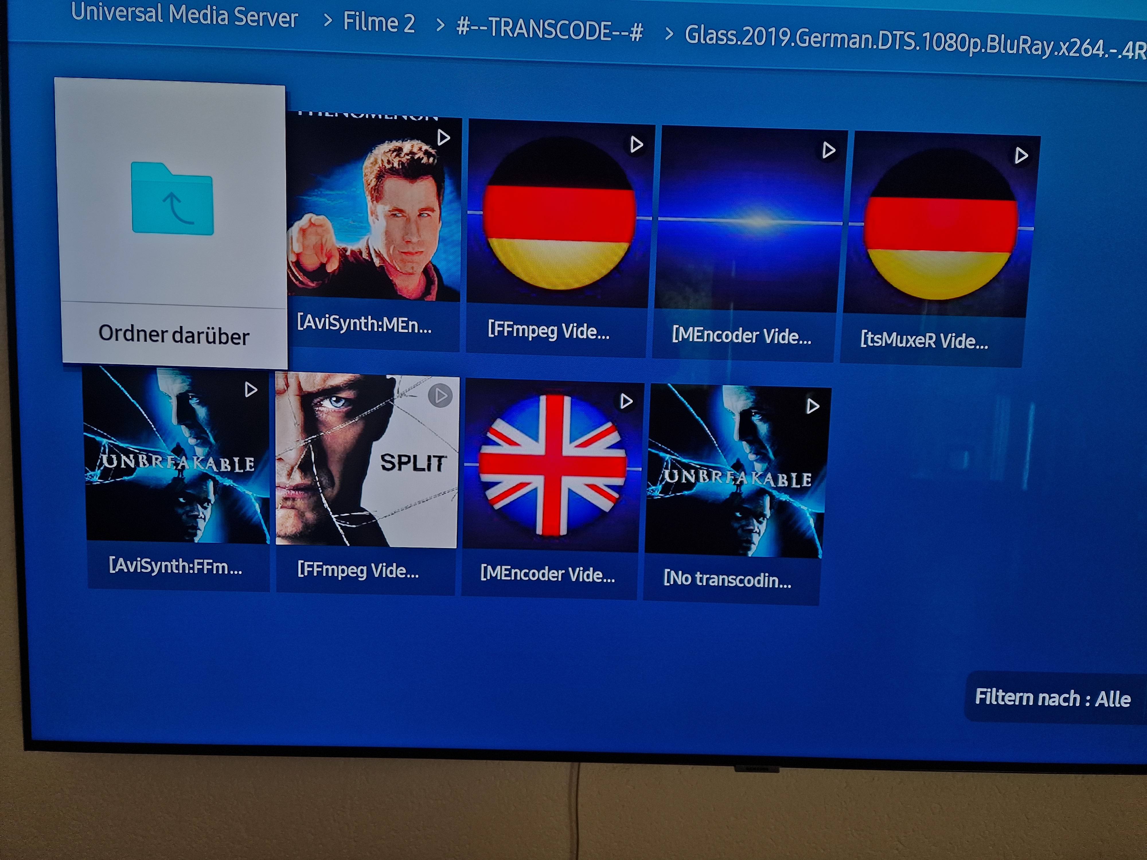

Re: No content found on my Samsung TV
Hi Boss
I have done this. When picking the movie with DTS "unknown Error" occures.
The other movies without DTS are playing well. So I thing its picking the right one...

And how do i turn off the video engines? It seems that i have another gui than you

To get to web settings double click on the try icon or go to http://localhost:9001/ on the computer running UMS
On the old GUI there is a button on the bottom that enables/disables the engine when you click on one.
