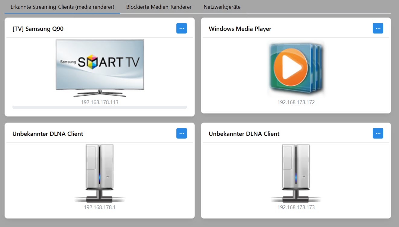

Regarding 192.168.178.173: This is neither my computer nor the computer where UMS is running, but just yet another laptop in my local network. I noticed that that laptop has a Windows Media Player as DLNA client running which was recognized by UMS thus shown in the dashboard, pls find screenshot attached. Sometimes it shoes the player as "unknown" DLNS client though. Is it perhaps kind of "network issue" when UMS is trying to identify media clients running around and smth goes wrong?!

- 13-02-2025_12-20-21.jpg (80.47 KiB) Viewed 12067 times
