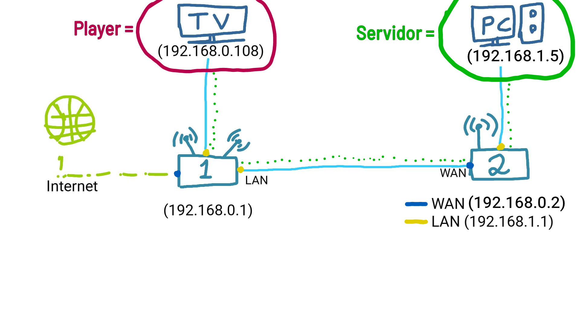

But actually, I have two routers connected on the same local network, and I want to access the server on the other router.
I'm trying to forward ports on Router 2, but Internet access would actually be access through Router 1.
I don't know how to explain it well.
Here is a picture of the topology of the network.

Accessing UMS from outside the local network is not it's intended function, I have heard it is possible but have no idea how to do it.
From what I remember it needs more than port forwarding to work as there are other protocols used for DLNA and UPnP that need to be shared between routers too, but that is my limit on networking knowledge.
It may work if both routers were on the same subnet, with all devices using 192.168.0.x instead of being split 192.168.0.x and 192.168.1.x

Re: Server not found via remote connection.
@Lukes
Is there a reason why "router 2" is set to a different IP range than "router 1"
It looks as if you have "Router 1" connected to the WAN port of "router 2" and "router 2 supplying DHCP services on a different IP range.
Your system would then be getting double NAT which is not good.
Cannot you connect "Router 1" to a LAN port on "Router 2" and then turn off DHCP on "router 2". In effect "router 2" would just be acting as a switch.
That way, all DHCP would be controlled by "Router 1" and the PC IP would be in the 192.168.0.x range.
Then port forwarding would just have to be done on "router 1".
