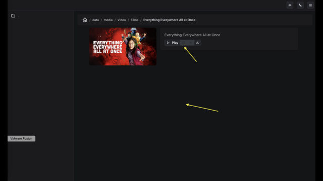

I start a clean installation (13.1) on a headless linux ubuntu server (22.04).
I see the content and can stream it to the renders. But in the webplayer I don't get the metadata for movies or series.
Have any one an idea what I do wrong or must I activate something?

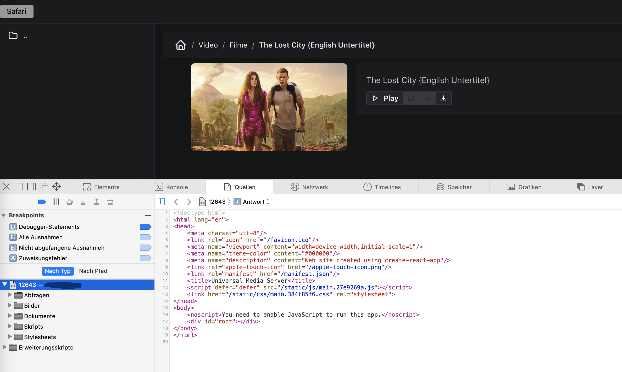

I think I found the problem.
I don't know why it took me so long
--> You need to enable JavaScript to run this app
But I don't know how to solve this problem.
Have anybody an idea?
Michael

Re: Missing the metadata
Sorry I completely forgot about getting back to this, I have not had much time recently.
I had a look at your latest logs and the error I was seeing is gone now so that was not the cause. There was something else I saw that might have been causing it but I had the same error in my logs, and after restarting UMS it was gone. I think the API might have been busy or down at that time.
Do you get the "You need to enable JavaScript to run this app" message in the web interface or are you only seeing it in the source?
You should only see this message when JavaScript is turned off as the message is in the <noscript> tags.
Your logs were missing the other files needed to properly diagnose. If you use the pack debug files option it will add all your used config files to the zip file.
Without them I can't give a definite answer but I think you have either disabled "Enable external network" or "Use info from our API" in the "External Outgoing Traffic" section of the General Settings tab in the options. You might have to start a new scan when you turn these on if they were off.
I think there is also a way to disable metadata in the shared.conf that is not yet possible in the web interface. It could be set to off but will need to see it to confirm.
I thank you for the time you spend to this request.
I attached now the diag file from the application include the config files.
The message with the "need to enable JavaScript to" I get in the browser.
Could you post a screenshot of the Javascript message you see?
No Javascript will prevent the web interface from working but should not effect the ability to get metadata.
Are you using an adblocker?
I could not see anything obvious in your UMS.conf file but it does look to be from an old version.
Might be best to delete it to reset the settings to default and see if that fixes it, then you can change the setting to what you want. You might have to start a manual scan of the files again or even better delete the database to start from fresh.
Some setting to make sure are enabled are "Enable external network", "Use info from our API" and "Enable the cache". Also try using the Media Library folder to browse the files.
The LG-webOS conf you are using is not doing much as it has been set to stream everything. Might be better to use the one from here that should work better and anything that the TV can't play will be automatically transcoded now.
I noticed something odd with your screenshot, I had to save it and zoom in as I could not see it properly on here.
There is some text saying "VMware Fusion", a quick google says it is a virtual machine. Maybe that is blocking the access to the API that gathers the metadata.
If it is inserting that text in the web browser then it could be altering other things.
The first post I created from a second clean installation. The other posts came from my main system. So sorry for the confusion.
Now I installed a fresh instance on my main system (Ubuntu 20.04.6 / UMS13.2.). Unfortunately without any changes. I create an new debug file from this.
Additionaly I added the screenshot from my browser screen. Adblocker and DNS Filter are all disabled.
Browsing through the "Media Library folder" was unsuccessful too
So I hope the best for this round
