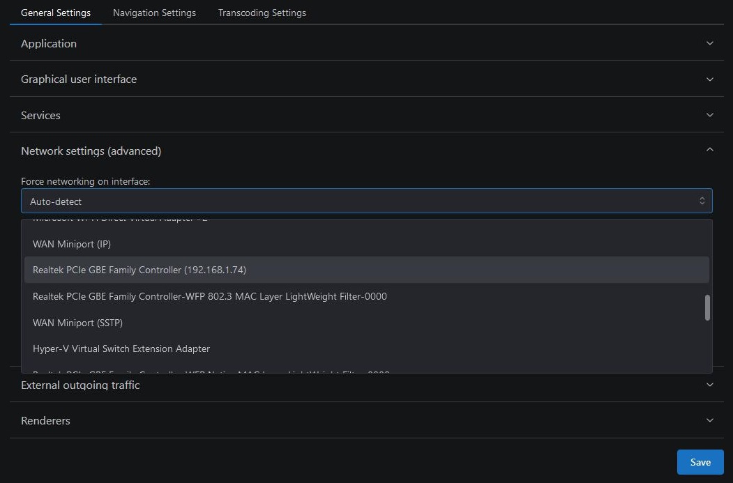

You could try forcing UMS to use the right Network interface, just change it from Auto-detect to one that shows your computer's IP address.
Clipboard Image (4).jpg (91.17 KiB) Viewed 19950 times
