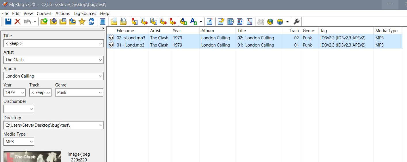

Hi, as per a question I posted here: viewtopic.php?p=47305#p47305 ,
I have some problems getting file to "enqueue" (but I can get them to play!) on my media server, A Cambridge Audio "Evo 75", which is a DLNA-enabled network streamer "all-in-one" unit.
The Evo is 100% happy with files served from Emby (or Serviio) on my PC, and with files served from my RAID/NAS which runs a Twonky server internally.
With UMS however, I have found that a simple and entirely legit filename change will affect whether the file can be queued or not on the Evo player. The Evo runs a version of GStreamer under a Linux port.
It comes to something quite simple (I think!)
This file will not enqueue:
01 - Lond.mp3
but the exact same file, with one character changed in the filename, will work fine:
01 -xLond.mp3 is fine!
Also, the string " - " [space, hyphen, space] WILL work, so long as the filename is 8 characters or fewer, so:
01 - Lon.mp3 works
and, for example
01 -London Calling.mp3 also works.
I am happy to report this to Cambridge Audio Support (they are excellent) if this is a bug in their code, but I would appreciate some details from you able how you parse files - I may otherwise get stuck in the middle between CA and UMS without some useful data!
I have attached log data for "working" and "not working", and UMS was restarted in all my tests, in hope this was the cleanest way to test.
This may also be useful, in case they show in the traces:
20-4E-F6-58-4D-53 192.168.0.120 Evo_75
FA-57-58-AB-79-2C 192.168.0.110 Ann_iPad [online but not in play]
DC-FB-02-DA-0C-35 192.168.0.108 RAID [Twonky embedded]
Windows 10 (64)
UMS 13.3.0

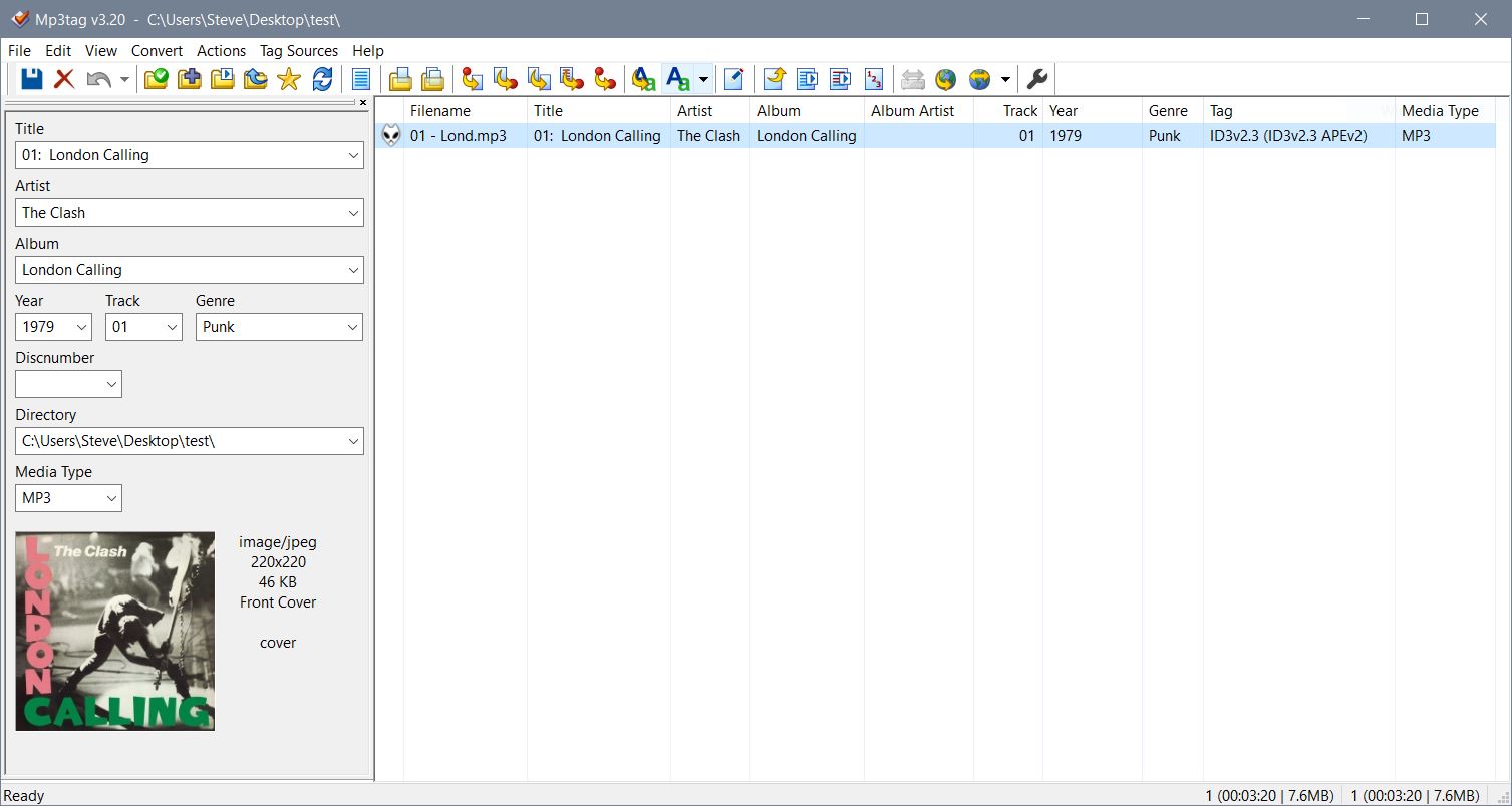

See MP3Tag image attached - N.B. APE tags are "MP3Gain"-related tags, and my other tests suggest they are not relevant to the issues.
Steve

This time I have UMS trace logs, where the scanned library contains two files, identical in MP3 music content, but with changed filenames and the tags changed (title, track_no), to make it easier to see what is playing.
You can see the files in the pic from MP3Tag.
In my media player, I tried to queue the file "01 - Lond.mp3" (but which is shown as "01: London Calling" in my media player i/f).
That file failed to queue.
I then tried to queue the file "02 -xLond.mp3" (but which is shown as "02: London Calling" in my media player i/f).
That file queued and I could start playing it fine.
Going back to the first file ("01 - Lond"), instead of trying to queue the file, I tried the option of "play from here" and both files loaded and were playable! How weird!
It looks like my media player has a bug when trying to queue files that originate with the string " - " included, if the filename is >8 chars, so I think the best outcome I can hope for is to see if you can identify anything I can report to Cambridge Audio's support guys that may help them pin down their bug. It doesn't really explain why the the data that Evo media player gets served from the same files from Serviio, Emby and Twonky always just work - there must be something the Evo can't handle with DLNA info just from UMS.
Apologies if this is a lot of effort for you, and I realize I'm probably the only UMS user that has this problem, but it is academically interesting for me to learn a bit more about DLAN/UPnP and why the data from the same files is different somehow between servers! Call me OCD!
Steve
Steve

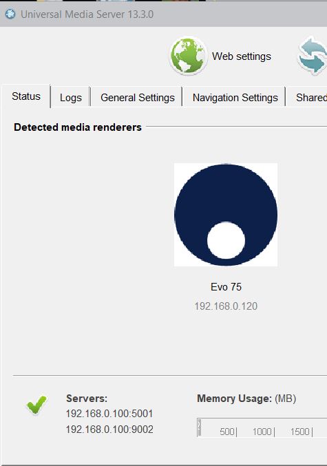

I had a quick look and one thing I noticed is your player is being identified as "Pigasus" which was a VR player that was added recently.
They both use the word "Android" in the user-agent string and the Pigasus.conf only matches that.
That player does not have any supported formats defined so everything is being transcoded. This may be part of the problem as it means even MP3s are being transcoded so some of the tags may not be sent.
I'll try and make a conf file for the Cambridge Audio. I found the manual that shows all the supported formats so should not be too hard to do.
I'll need to dig in deeper with the communications between UMS and your player to find out why the filename makes a difference.
I did compare 2 parts with each file and it seemed almost the same except the duration was different in one of them, this may have not been the main file and only a preview though.

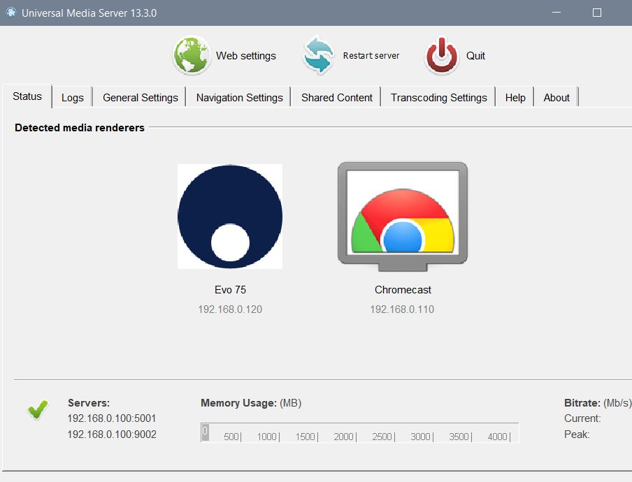

Re: Possible filenanme parsing problem.
Awesome - thanks so much for the efforts!
Here's what I found so far (I will get logs later)....
1) Copied the Evo conf into to the renderer folder and started UMS.
2) As before, the old-setting console view showed the CA logo for the Evo at 192.168.0.120 (it's a fixed DHCP address) - see pic 1. This is what I have always seen on the console....
3) Started the CA "StreamMagic" app on my android phone (this is the control surface for queueing/playing/managing the Evo device at .120) and the Pigasus icon appeared (as before) in the console window with address 192.168.0.110 (confirmed as my Android phone). UMS appears in the list of servers on the stream magic phone app as usual.
4) Navigated the StreamMagic (SM) app to folder on my PC and tried to enqueue the "bad" file. It failed.
5) Removed the "pigasus.conf" file from UMS's renderer folder, having realized that UMS identifying my phone as pigasus was maybe not a weird artefact, and may in fact be important!
6) Restarted UMS (quit the whole app and restarted) and now the console shows a chromecast device at .110 (my phone) instead of pigasus - see pic2
7) And now the good bit: Navigated to the folder with the test files, and the "bad" file ("01 - Lond.mp3") enqueued perfectly!
Interim conclusion is that it's something to do with the SM app on my phone (@ .110) - when UMS thinks it's pigasus, I get the enqueue failure, but when UMS thinks it's a chromecast device (possibly just some default?) everything is fine (so far). I am not yet certain whether the mp3 file is being sent to my phone and relayed to the Evo unit, or if it is being sent by UMS directly to the Evo (@ .120) which I believe is what normally happens and no idea if the data gets transcoded or not. I'll play later today and let you know what I find.
Apart from getting more logs, are there any useful tests I should try? Should I remove (or disable) the chromecast.cfg file to see what happens?

Should I have put the .png image of the Evo you attached somewhere in a UMS folder as well as the .cfg file?
I saw no image or mention of Yamaha-RXA2050 in all the tests above....
Also, yes, it is coincidence that the track in the CA .png image is the same track as I'm using as a test (I have been practising it on my guitar!)
