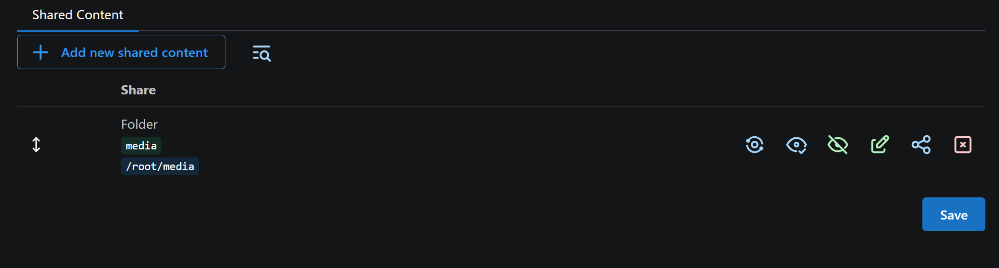

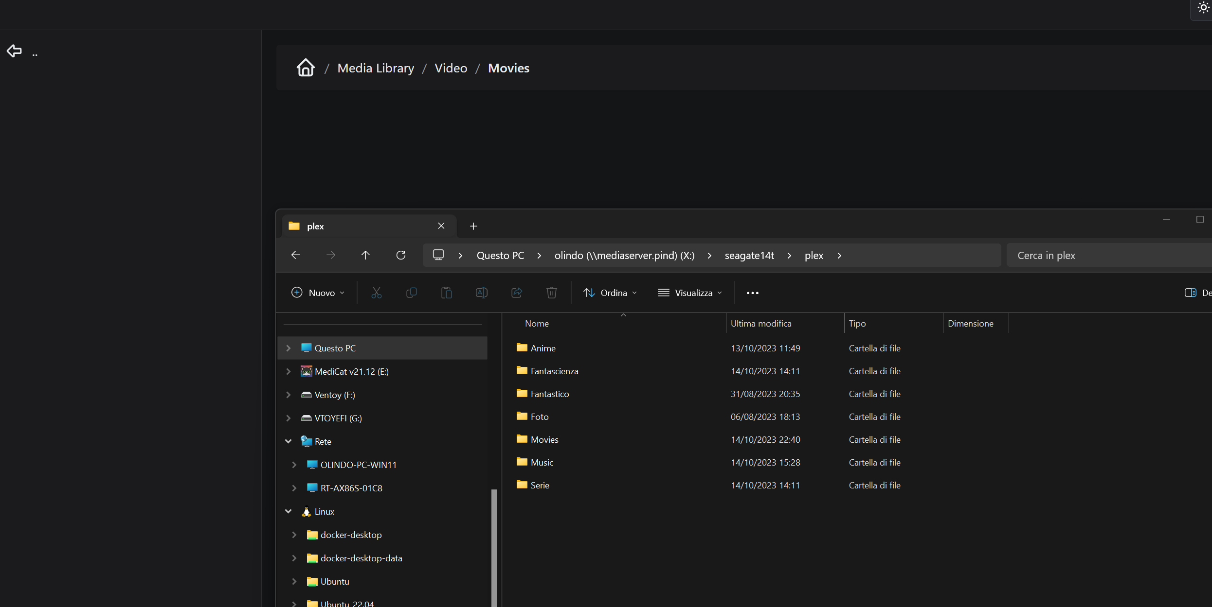

i follow this guide suggested in site:
https://support.universalmediaserver.co ... ion/docker
in pariticular i fetched configuration from
I tried I added the share of 9002 port
Do you need other info?
Thanks a lot
Olindo
wget -P "$rootDir" \
"https://raw.githubusercontent.com/Unive ... rces/$file"
This is the mapping beetwen my dirs and which used by the container (on the right) . PLEX is not active when I start UMS so there isn't no contentionvolumes:
- '/home/olindo/seagate14t/plex:/root/media'
- '/home/olindo/UMS/.config/UMS:/root/.config/UMS'
How I can limit searchig in /root/mediaCould not match any format to "/root/.config/UMS/database/medias.trace.db"
and now i can see the player interface but /root/media doesn't match which i mapped (il plex windows there is the real content)- '9002:9002'
Thanks a lot
Olindo
- share2.png (98.85 KiB) Viewed 4376 times

Re: Complete Docker installation, and now?
In your SHARED.conf it has the UMS directory
This will be why it was trying to add the database to itself
I don't know why it is there as it does not show in your screenshot. You could manually edit this in a text editor to just remove these lines.
Maybe this has corrupted the database trying to add all these files so might be worth deleting it so it will be recreated on next run.
I'm not too sure about the "/root/media" one either. I know very little about Linux and even less about Docker, but should this not be something like "/home/media"?
If your media is on a different part of your system I don't know how to map that location into Docker, or what to put in your shared folder list.
It may be how you have it is correct.
I can't say that I have had any experience with docker.
But looking at your previous messages it appears that the install is much the same as other Linux installs.
Personally, I would remove all the UMS folders/files and start again.
I see you posted this:
"file": "/usr/src/ums",
"monitored": true,
"metadata": true,
"active": true,
"type": "Folder"
usr/src/ normally contains the Linux kernels.
I would definitely NOT put your UMS install there.
Place the UMS install in: /opt/ums
The configuration files (SHARED,conf, UMS.conf etc) should go into /root/.config/UMS and should be created there automatically.
Your media files are at "/root/media", I can see from your logs that is the actual location
As mik_s says, that seems a bit strange but there is no reason it would not work.
I would make your SHARED.conf file (/root/.config/UMS/SHARED.conf) so it shows different folders for your media like on your computer.

"file": "/root/media/Fantastico",
"monitored": false,
"metadata": true,
"active": true,
"type": "Folder"
"file": "/root/media/Foto",
"monitored": false,
"metadata": true,
"active": true,
"type": "Folder"
"file": "/root/media/Movies",
"monitored": false,
"metadata": true,
"active": true,
"type": "Folder"
"file": "/root/media/Videos/Music",
"monitored": false,
"metadata": true,
"active": true,
"type": "Folder"
"file": "/root/media/Videos/Serie",
"monitored": false,
"metadata": true,
"active": true,
"type": "Folder"
As I said, I know nothing about Docker, but if you can make your installation as above, we can iron out any issues after that.
