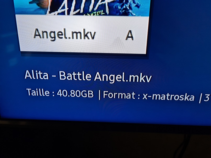

UMS is not correctly detecting the TV it is using the wrong rendering engine.

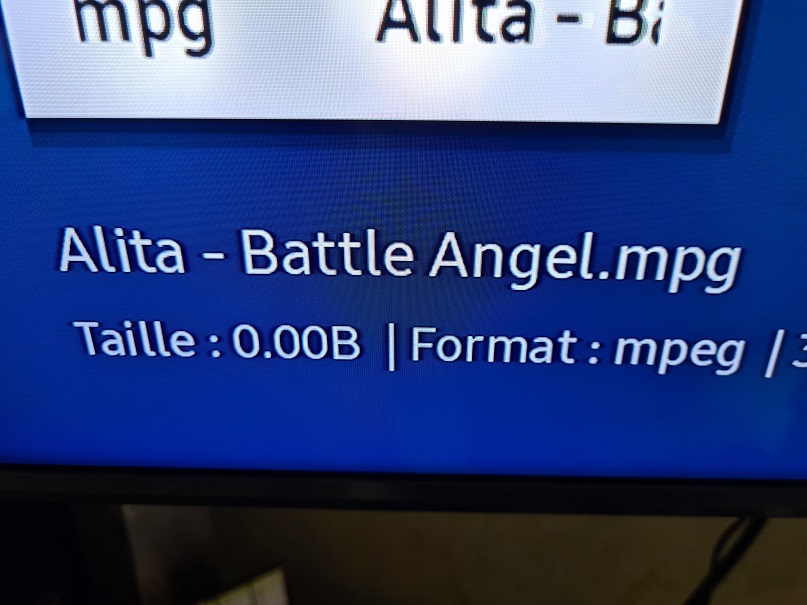

Unable to launch 4K mkv media, mkv media are read by UMS as mpg media (1st picture )
When I deactivate mkv transcoding, the media plays correctly but the sound is not present (DTS codecs)
The DivX and DTS codecs are not supported by the Samsung TV models released in 2023
I could not find the Samsung QLED 4K 2023 Q68C television in the list of rendering engines

From your description this is normal as DTS is not supported on that TV so the file has to be transcoded to a mpeg stream to be playable.
As the transcoded file does not exist yet it will have a file size of 0.

Hello, I tried the new configuration Samsung-TV-2023.conf no video started.
Video 1 and 2 1080p .mkv
Video 3 and 4 4k .mkv
ums_dbg_2024-03-06-15-41.zip
(994.28 KiB) Downloaded 7435 times

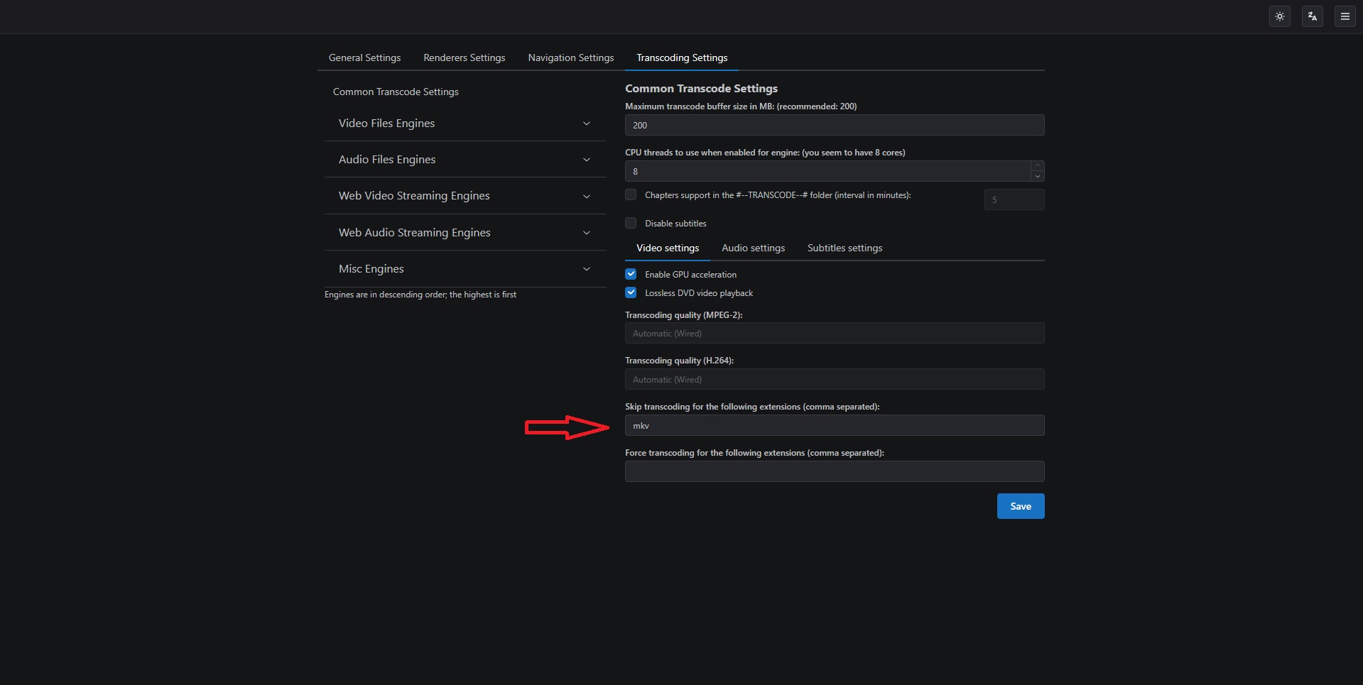

2nd try Transcoding parameters (Do not transcode the following extensions) mkv
With this setting All videos started correctly, 4k videos played perfectly, some even weighing 70GB
ums_dbg_2024-03-06-15-46.zip
(500.07 KiB) Downloaded 7311 times
Below 3 screenshot:
Picture 1, Screenshot on TV, test 1
Picture 2, Screenshot UMS Transcoding Settings, test2
Picture 3, Screenshot on TV, test 2

I have the impression that Samsung TVs do not support UMS transcoding, because on all videos the extensions are no longer in .mkv on the TV menu.
I tried with the network cable, it didn't change anything, videos marked .mkv launch correctly, videos that UMS modifies in Format: x-mpegURL do not launch
Posts: 1446
Re: Renderers Samsung QLED 4K 2023 Q68C
They will not be MKV if they are transcoded.
In that conf it uses the profile "HLS-MPEGTS-H264-AAC" which uses the "x-mpegURL" mime type so those pictures are correct.
As transcoding is happening in realtime then UMS cannot send a file size to the renderer as the file does not exist yet, so showing as 0.00 bytes is normal.
Samsung are not great with transcoding videos as they use the seek-by-byte method instead of seek-by-time which will disable being able to FF or RWD the stream.
With HLS this should overcome this limitation as it works something like cutting up the file into chunks and using a playlist. This is how Youtube works for example.

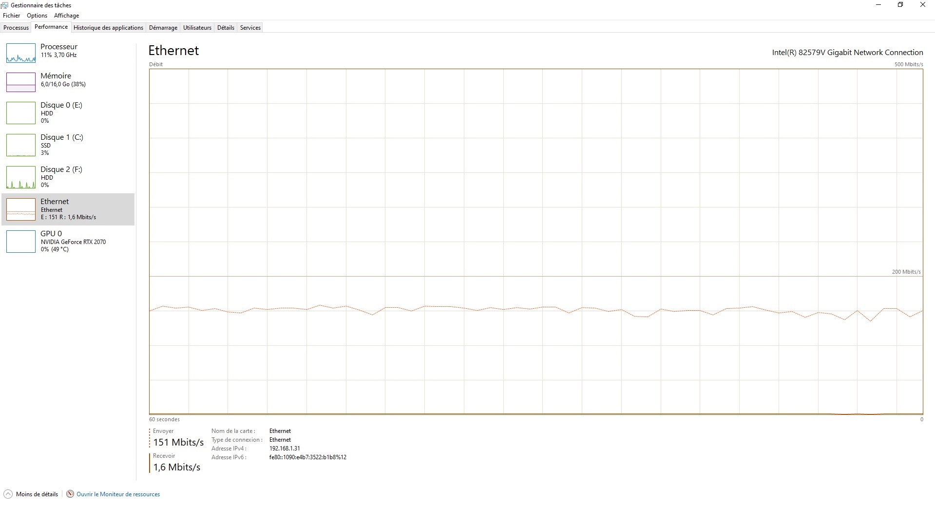

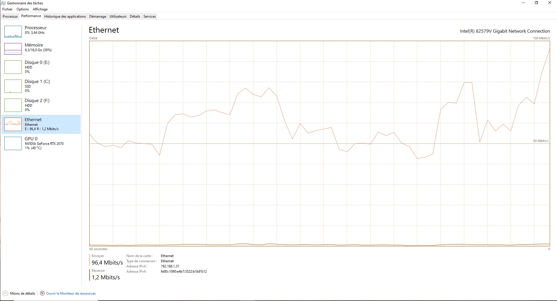

Hello, indeed UMS does not detect the network correctly, I deactivated "Use automatic maximum bandwidth" and set the parameter to 0 (1Gb/s)
I did a test with an ethernet cable on the TV, automatic UMS detection:
Renderer Samsung 2023 (QE1C/Q6*C Series) has an estimated network speed of 17.664 Mb/s
UMS should at least theoretically detect a minimum 100Mb/s network automatically in ethernet
Wifi TV network test playing Avatar 4k:
Renderer Samsung 2023 (QE1C/Q6*C Series) has an estimated network speed of 2.208 Mb/s
Actual throughput up to 100 mb/s in Wifi:
Monitoring 3.jpg (225.18 KiB) Viewed 31119 times

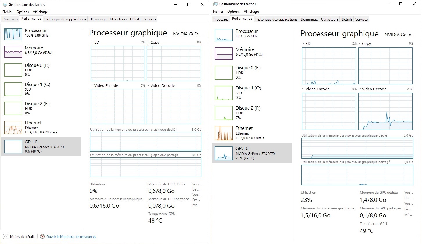

I noticed that when UMS transcodes videos it does not use the graphics card, only the processor (I had already tried to activate the Enable GPU acceleration setting, but that doesn't change anything)
I launched this same video in 4k on VLC it works perfectly below 2 captures of the UMS task manager (Picture left) and VLC (Picture right)

I don't understand why UMS tries to transcode certain video (Avatar 4K) unnecessarily when the television supports all codecs.
In the transcoding settings I added the mkv extension in (Do not transcode the following extensions) this gives me better results

Your network speed to your router probably won't be the speed to the TV as manufacturers won't use expensive Gigabit ports on TVs so will be limited to far less than 100Mb/s depending on how much money they want to save on the port. For a wired connection 17.664 Mb/s is much better than the 2mb's on wifi but still seems slow. Maybe something is interfering with the speed test on your computer or your TV is just not responding quick enough to the ping.
A better way to measure the speed will be if there is an app on the TV to do it but not sure there is any available. If there is a web browser on the TV then you could use OpenSpeedTest running on your computer to do it. More info in this video. This should give you a better idea if the measurement in UMS is wrong.

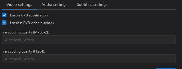

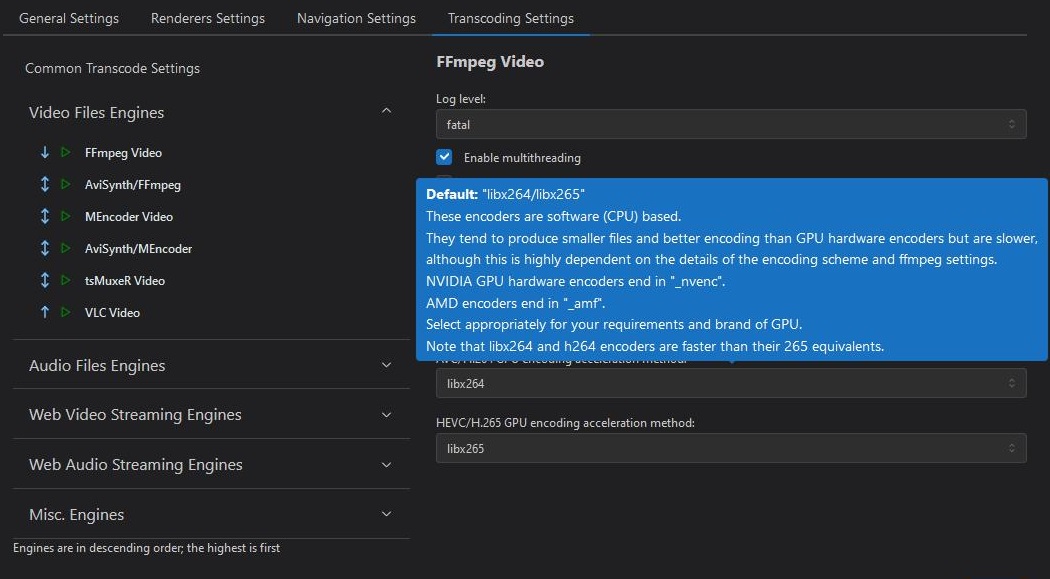

I don't have a graphics card that is able to do encoding so I don't exactly know what settings to use but try one of these.
I'm guessing you will need to use "h264_nvenc" for "AVC/H.264 GPU encoding acceleration method"
Clipboard Image (4).jpg (128.04 KiB) Viewed 31111 times
and make sure GPU acceleration is turned on (it shows it off in your settings)
Clipboard Image (5).jpg (13.92 KiB) Viewed 31111 times

Concerning the network, WIFI, 2,208 Mb/s is what UMS detects, which is false because while the video is playing I have 150MB/s coming out of the network card to the TV via WIFI
Connexion Wifi.jpg (193.37 KiB) Viewed 31105 times
For an Ethernet connection on the TV UMS detects 17,664 Mb/s on 100
For GPU encoding acceleration I followed your advice but only VLC video uses the GPU, the other encoders did not use the GPU (FFmpeg Video...)
