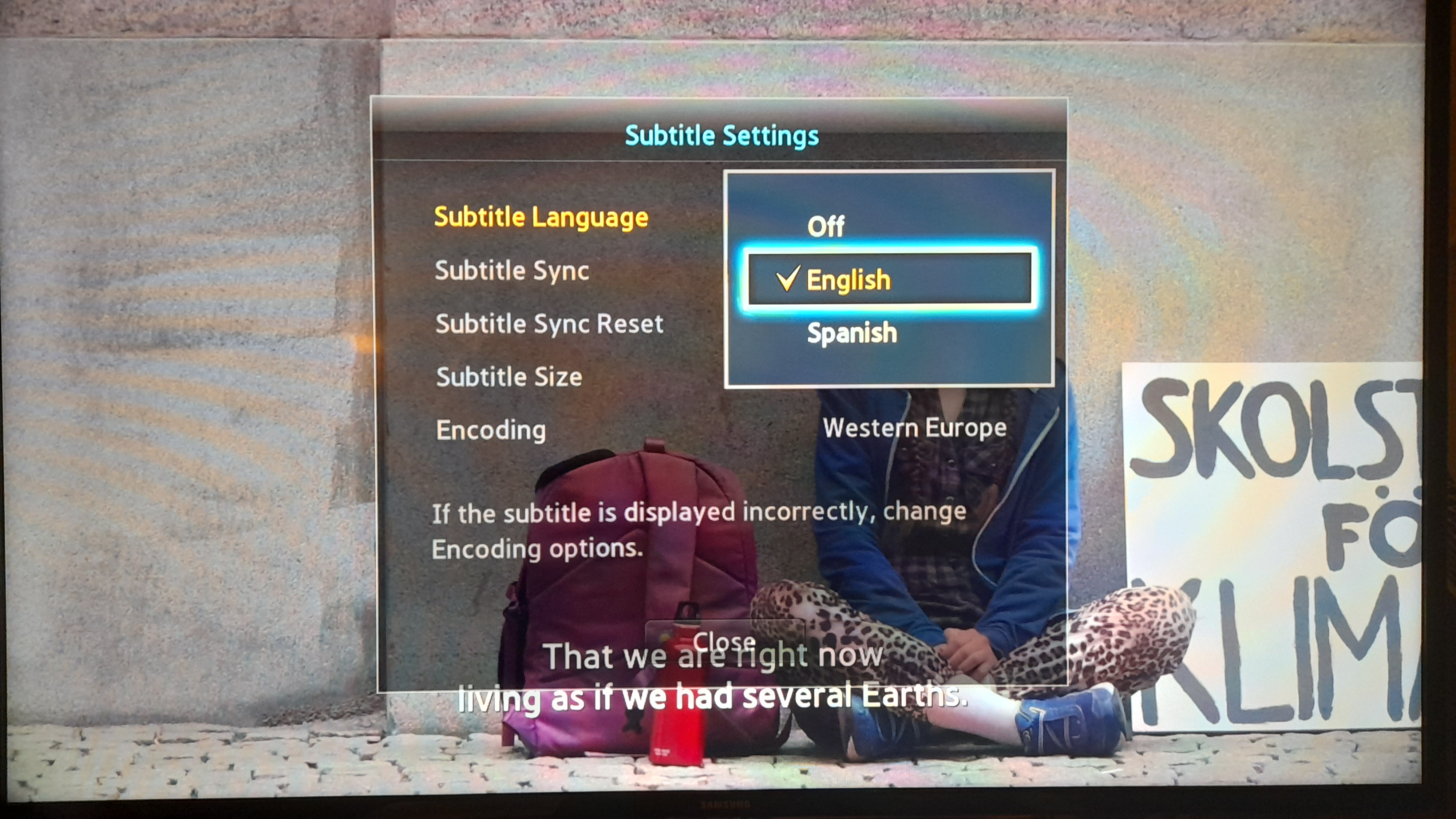

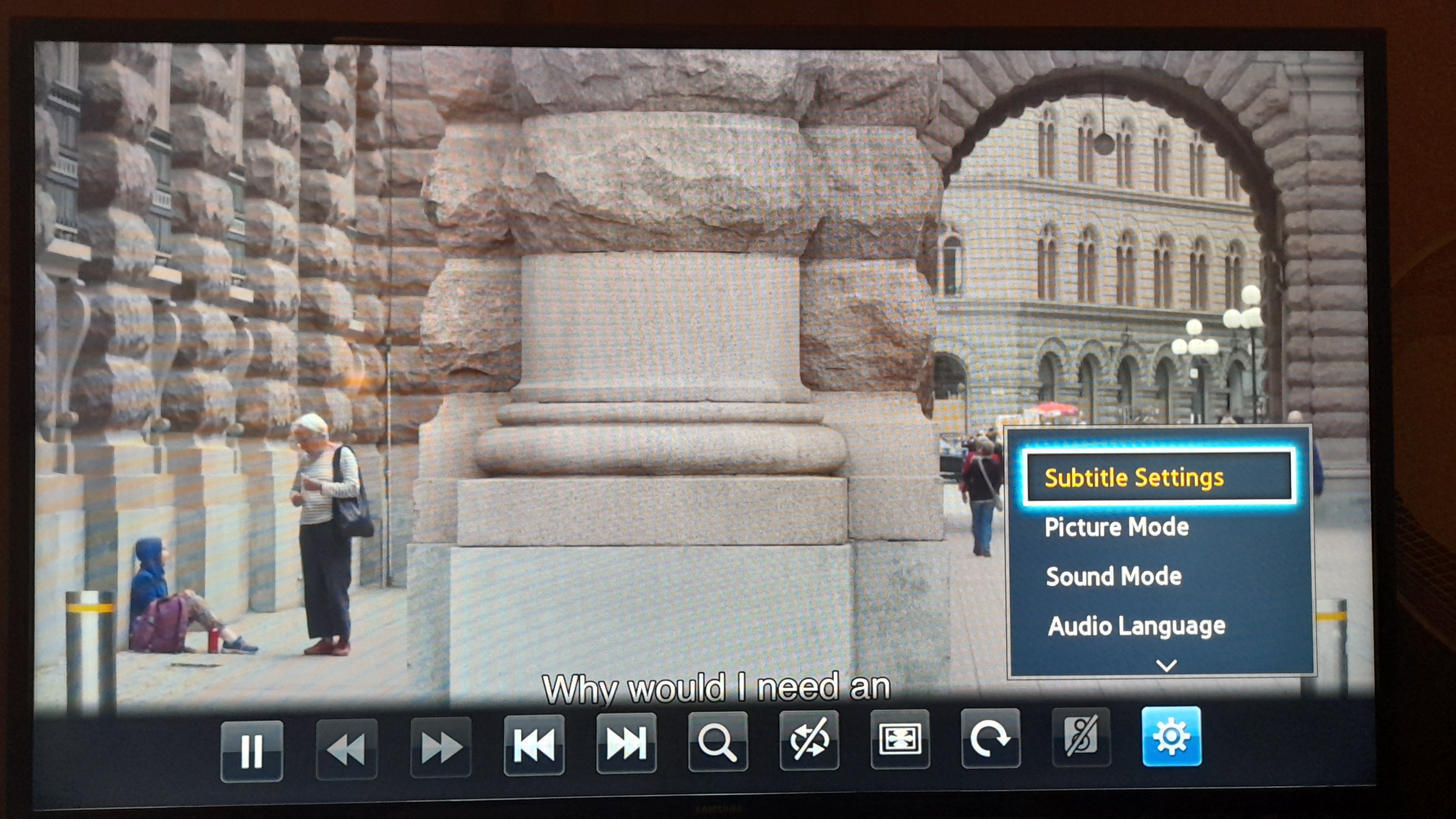

My old series F Samsung TV has a AD/SUBT. button on the remote that should bring this up but testing it now it just gives a message "not available" so it may be only be for normal TV. I have no idea if this has changed on newer models.
There is subtitle settings where you can select the language and turn them on and off when the video is playing.
This is what shows on mine and works with external subtitles too. Another thing you can do to see if UMS detects the external subs is to use the option "Add subtitle information to video names:"
If set to "Basic" and it will add {English subtitles} for example to the filename. If you set this to "Full" it will show something like {Stream Ext. Sub:Subrip:English}

The subtitles should work on the TV, there should be somewhere you can select the subtitle stream.

Re: The subtitles should work on the TV, there should be somewhere you can select the subtitle stream.
Ans: The remote has an AD button, but as you stated, it only works for "normal" over-the-air TV broadcasts. Even though this is turned on, it has no effect on streaming media.
Re: There is subtitle settings where you can select the language and turn them on and off when the video is playing.
Ans: I have never seen a selection for subtitles while playing videos in the years I have been using UMS. It just displays the subtitles as I have configured in UMS.

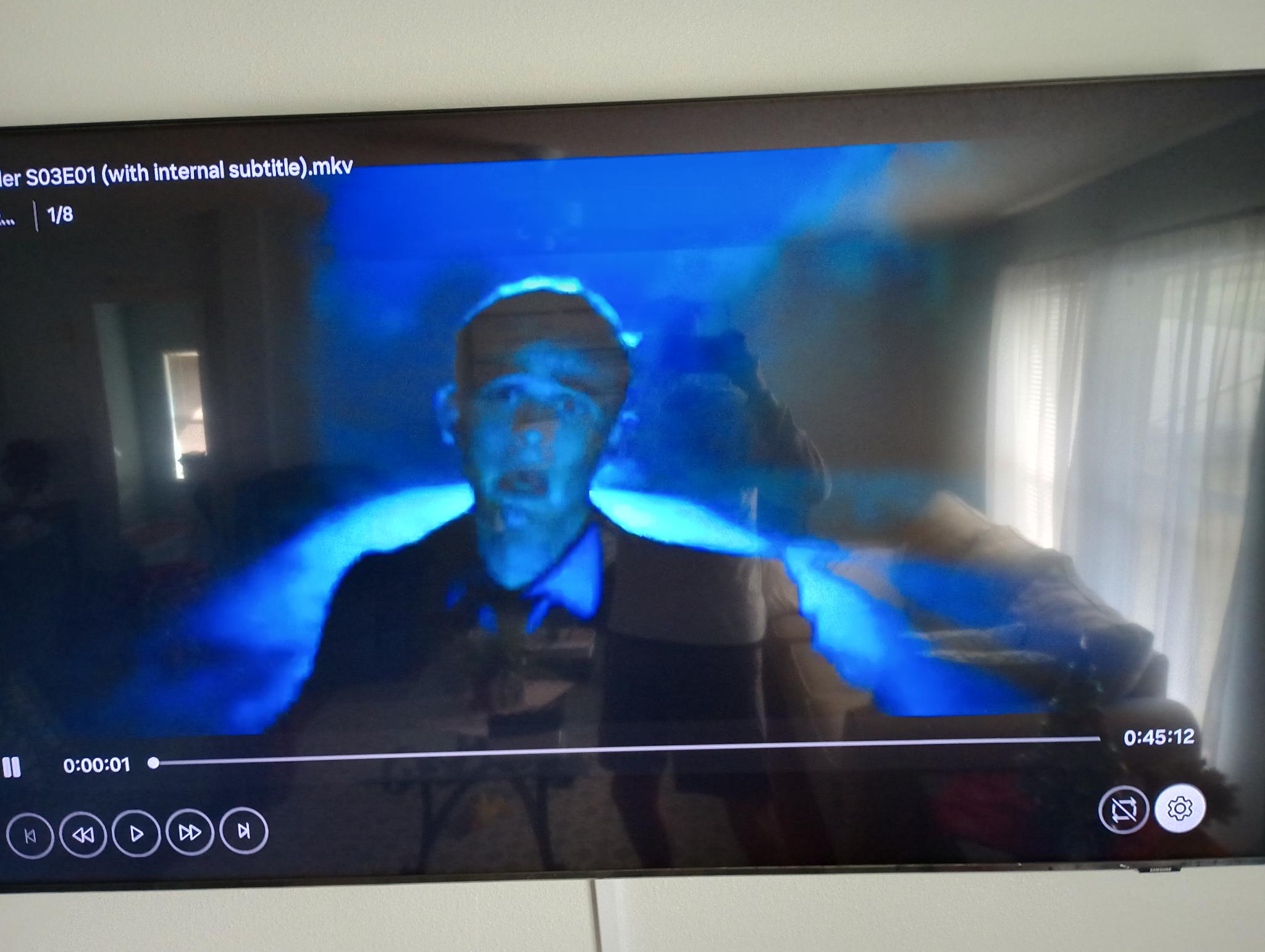

Does it display the controls like my first picture when you press the enter/select button (the one in the middle of the arrow buttons) on the remote?
Can you change subs when playing a MKV file with multiple internal subs?
If not could you take some pictures of what the controls looks like and when selecting the gear option and the subtitle setting menu?

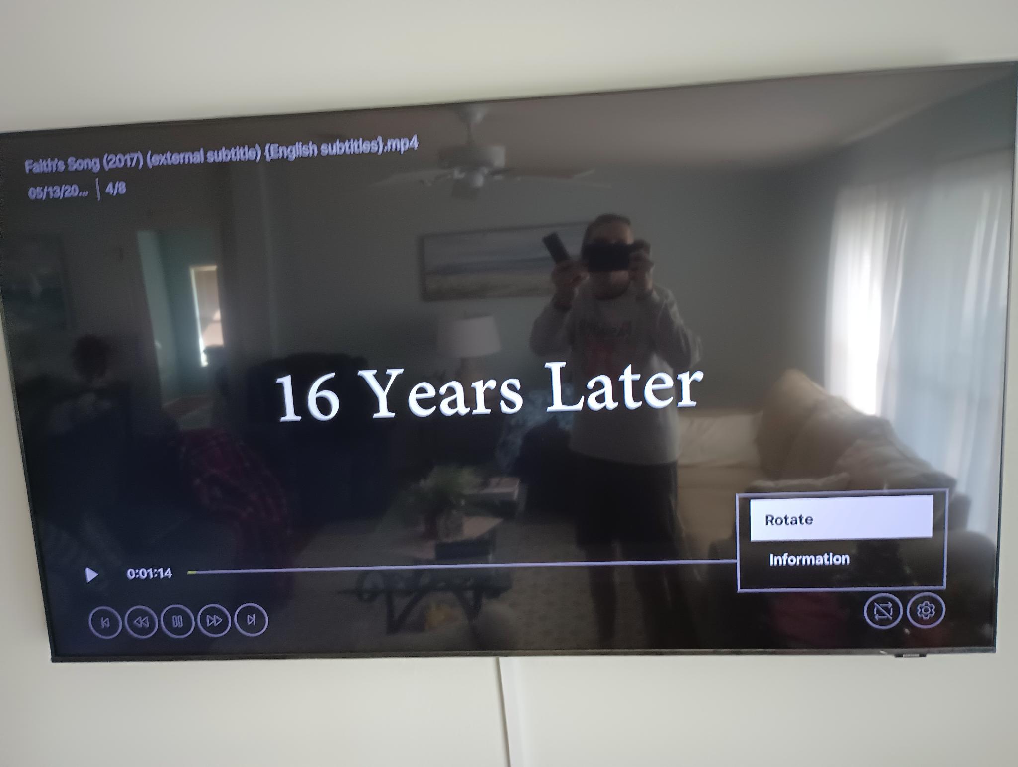

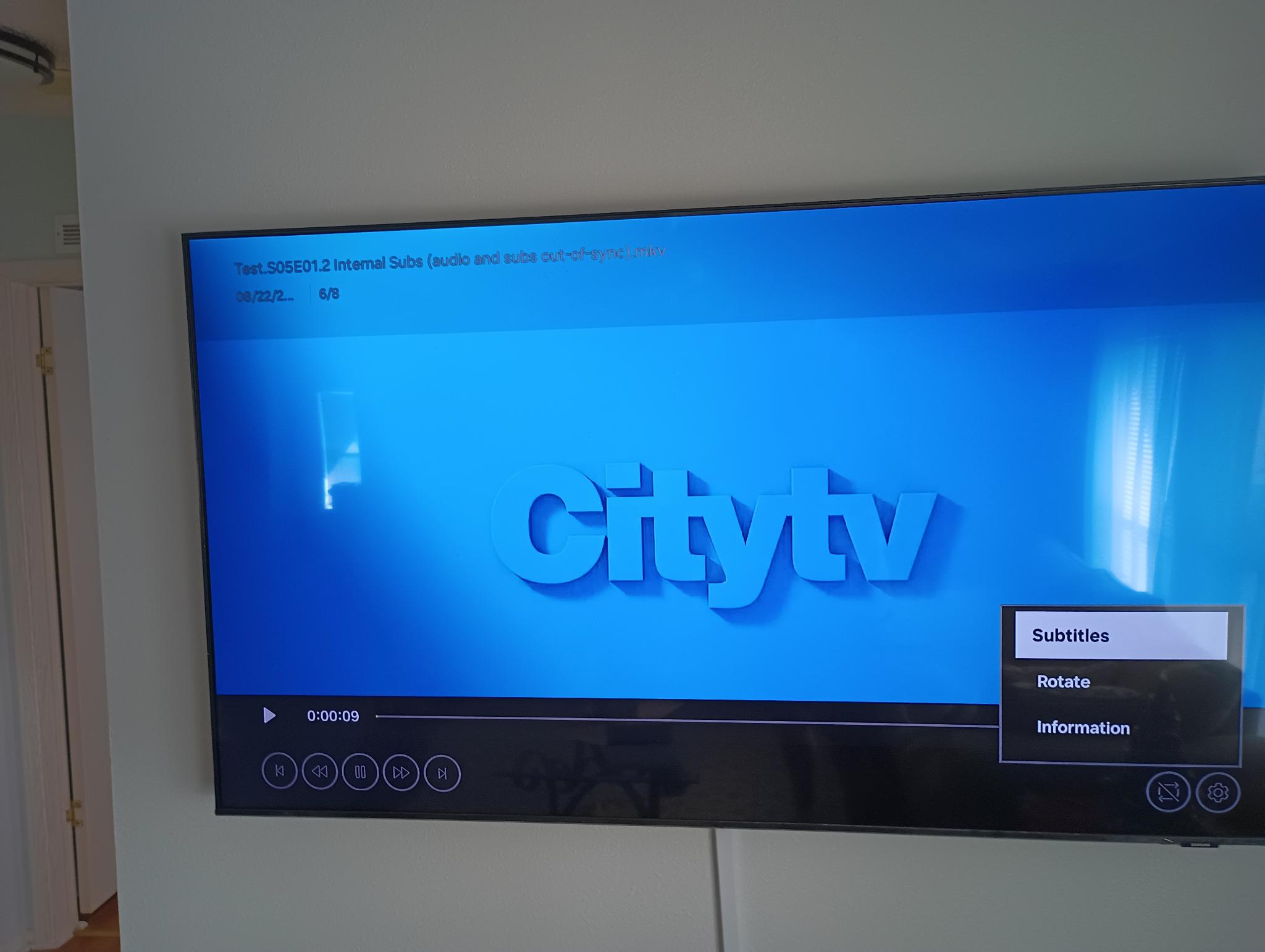

Re: Does it display the controls like my first picture when you press the enter/select button (the one in the middle of the arrow buttons) on the remote?
Ans: When hitting the enter/select button, it displays the settings/options menu below. However, there is no option for EXTERNAL subtitles...only Rotate and Information. There IS an option for subtitles when the file has INTERNAL subtitles. About 95% of my videos have external subtitles. So I need to get it to work with external subs.

In a nutshell, it appears that there is a difference in the way Samsung handles EXTERNAL subtitles versus INTERNAL. Maybe that can help us troubleshoot further.
Thank you.
Kurt

I created a copy of the video file that does not work with an external subtitle (video plays but subtitles do not show up). The video file with the internal subtitles works fine.
It seems like there must be something in the renderer file that is allowing subtitles to work with INTERNAL subtitles in files, but not working all the time with EXTERNAL subtitle files.
Will this help with the troubleshooting to find a solution for External subtitles?
