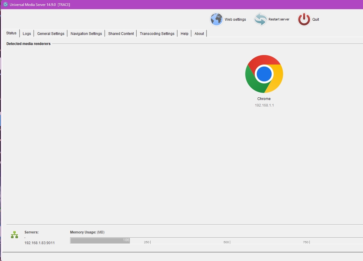

Numerous things like that, and NO list of videos in the webPlayer.
Showing my Router as a media device - which it is not, but not showing my computer or Chromecast, or Smart TV or ROKU...

The Forum would not attach this 4th picture/screencapture, don't know why ...

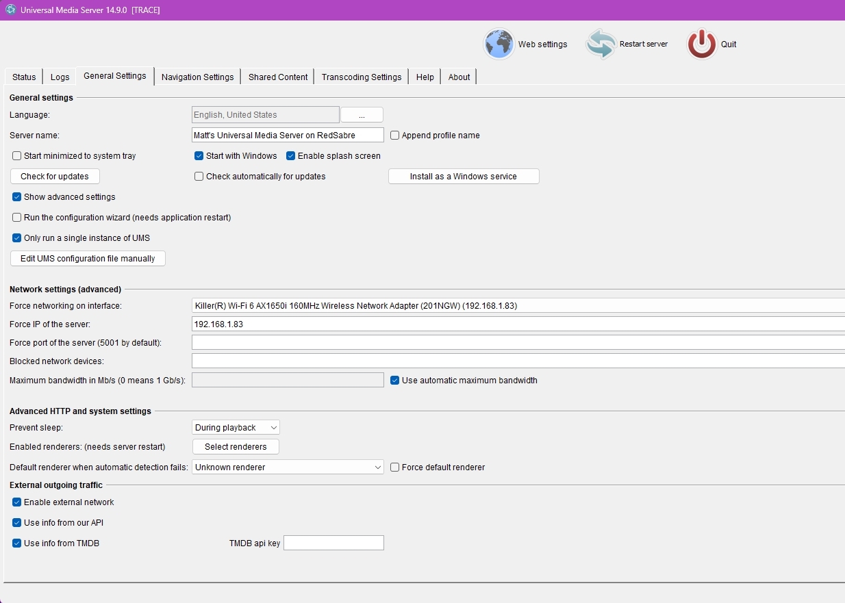

One thing I noticed on your last screenshot is that UMS is using port 9011 when it should be 5001 by default. Did you change this?

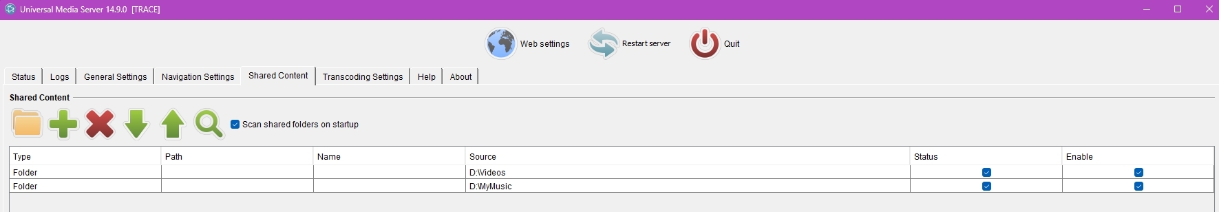

At first, just tried "Updating" from 12.1 to 14.9.0, the result was my initial request for some help & direction... then I uninstalled any and all UMS items, Cleaned the Registry, rebooted several times, then clean install 14.9.0

Port 5001 is still used by UMS, I did never have to change that on any version.
Port 9002 is not used.

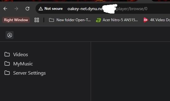

UMS/Audio Directory/Video Directory and Video playout has shown in browser at {http://www.****-net.dynu.net:9011/player/browse/132} just fine, forever.

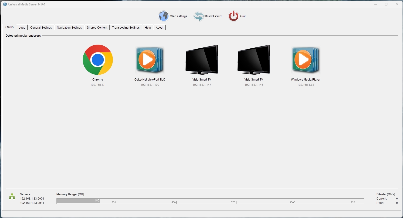

And now in this pic, none of the 3 Roku's show up here, nor does whatever is at 192.168.1.157 ...

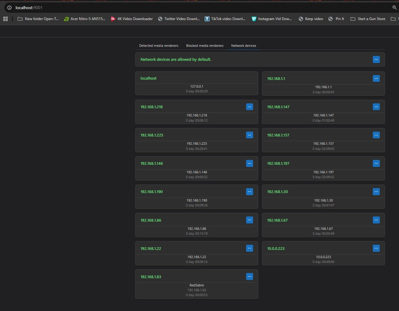

But here in the Server page, the pic shows many different IP's ...

Do you not think you are leaving yourself exposed with the setup you have?
I can access your media server.
I can restart your UMS.
I can shutdown your UMS.
I could watch movies on your UMS. I guess that would only be a problem if you were paying per GB for your internet connection.
But... if a few unauthorised people were watching, when you wanted to watch a movie from a remote location, the bandwidth to you would be reduced.
Furthermore, most of your computer (inc personal information) is open to the public on a certain port (which I won't write here) and all of your personal files can be downloaded.
