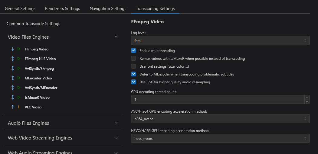

As for the h265 encoding I don't know why someone set this as not everyone will be able to encode using it.
You could change the transcoding profile to "MPEGTS-H264-AAC", or if it works "HLS-MPEGTS-H264-AAC" for better transcoding playback if you don't use external subtitles as this is a limitation with HLS
I can also see you have not enabled your GPU to do this so it just using the CPU. You set this up in the transcoding settings for FFmpeg and use the _nvenc encoders for Nvidia cards.

Thanks for all the information.
I had tried all "_nvenc" options one by one, nothing have worked.
This was done before I wrote "dtshd" on the .conf. And the question again is: why it tries to re-encode? the way the .conf was it should know my TV understands the video and the external subtitle part of the movie at least. It would be less troublesome if it tried to re-encode only the audio part. Or is it impossible/hard to do?
