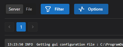

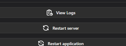

Since UMS is actually running you can put it in trace mode to get more information and use the web UI to pack the logs.
First you will need to quit UMS and manually edit C:\ProgramData\UMS\UMS.conf to change
to
Then you can pack the logs from the tools menu (View logs > options > pack debug files) after running UMS again. This link should take you to the right place.
Note there is a very minor bug in this version where you save the logs it will add "_" to the start and end to the zip filename.
This has recently been fixed but you can just rename before posting them.
