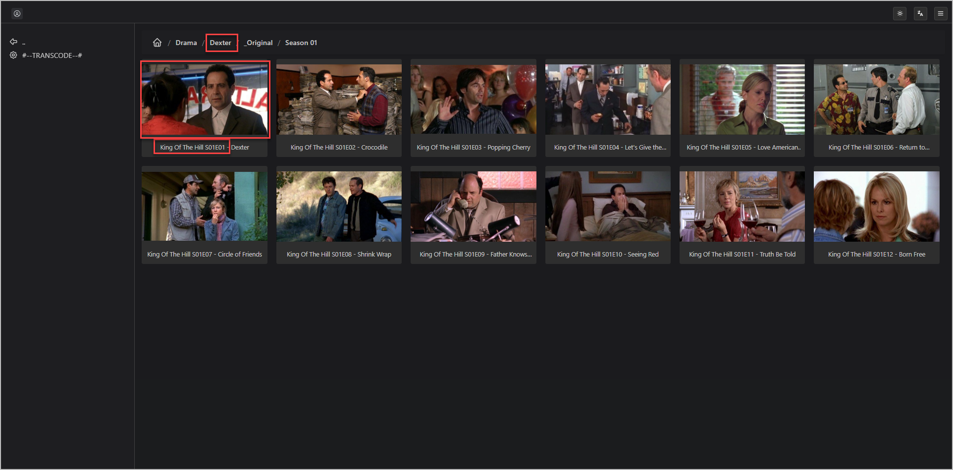

Hi all,
I have been having this issue for a few months, I'm not even sure when it started. It's about wrong episode names and sometimes thumbnails, like this:
As you can see, it's a Dexter episode with Monk thumbnail and King of the Hill name. I have cleared the cache several times, but things only change a little; it's never completely fixed.

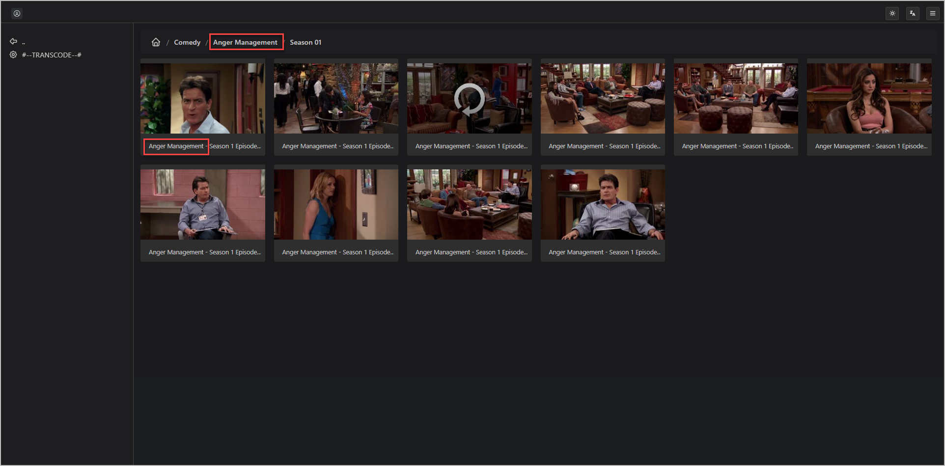

Not all files are affected, though:
Anger Management.png (638.16 KiB) Viewed 96893 times

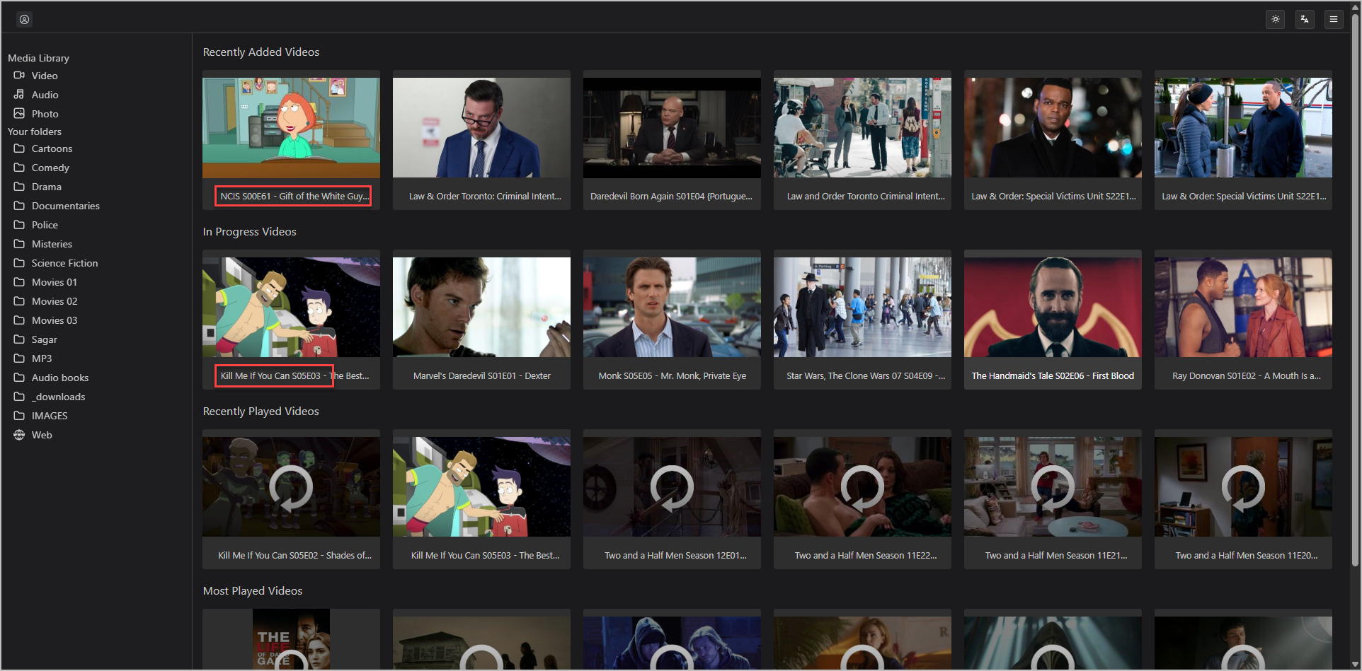

In this image, you can see that Family Guy is wrong, but it was right before the cache reset. Lower Decks didn't change, it was wrong both times:
Right to wrong.png (1.2 MiB) Viewed 96893 times

The situations above happened with Prettify filenames checked. If I uncheck it, the names are displayed correctly, but the original names are too ugly.
Thank you for your great job!

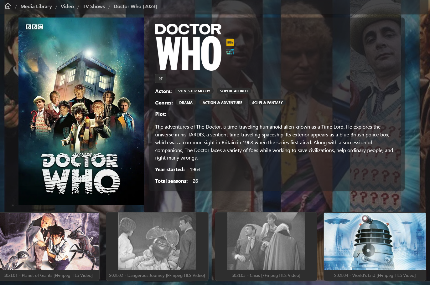

I came across something recently where the wrong episode names and thumbnails was coming up for the new Doctor Who so there may be an issue on the API side of things not retrieving the correct metadata (does not help they reset the season number with the new Doc).

I have not looked at your logs yet but I think this is the same problem.
