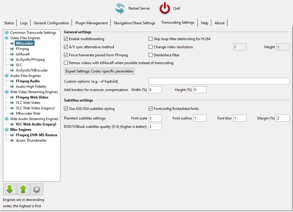

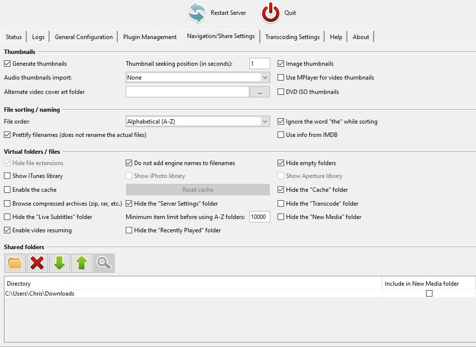

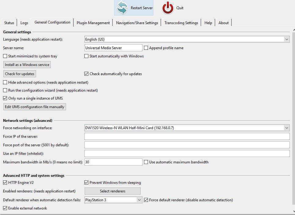

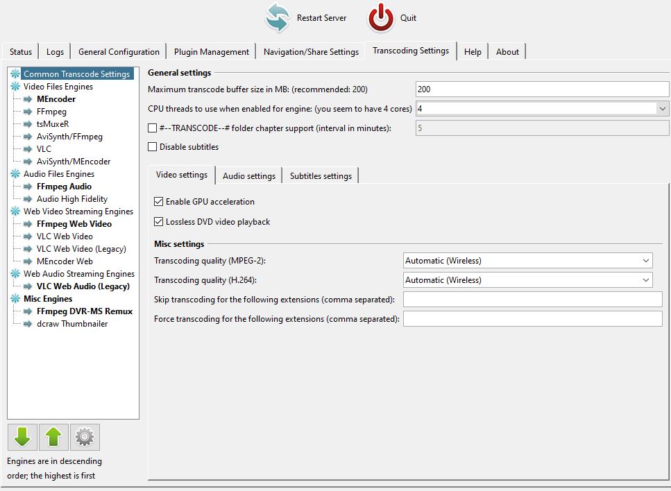

I'm at a loss to try to get this working. I have read all the previous threads but I can't seem to get this working again. I've don the UMS version 5.2.2 update and and it's basically I fresh install the settings before were not saved bc it wasn't working with the previous version since the update. I've tried the windows firewall port forwarding on 5001. It is not able to see connect to my PS3 and vice versa.
Can someone who has the Windows 10 upgrade guide me through their settings so I can get back to having this awesome program back to normal?
Any help leading to this goal is appreciated!

- 3.JPG (96.19 KiB) Viewed 19758 times
- 2.JPG (41.94 KiB) Viewed 19758 times
- 1.JPG (89.97 KiB) Viewed 19758 times

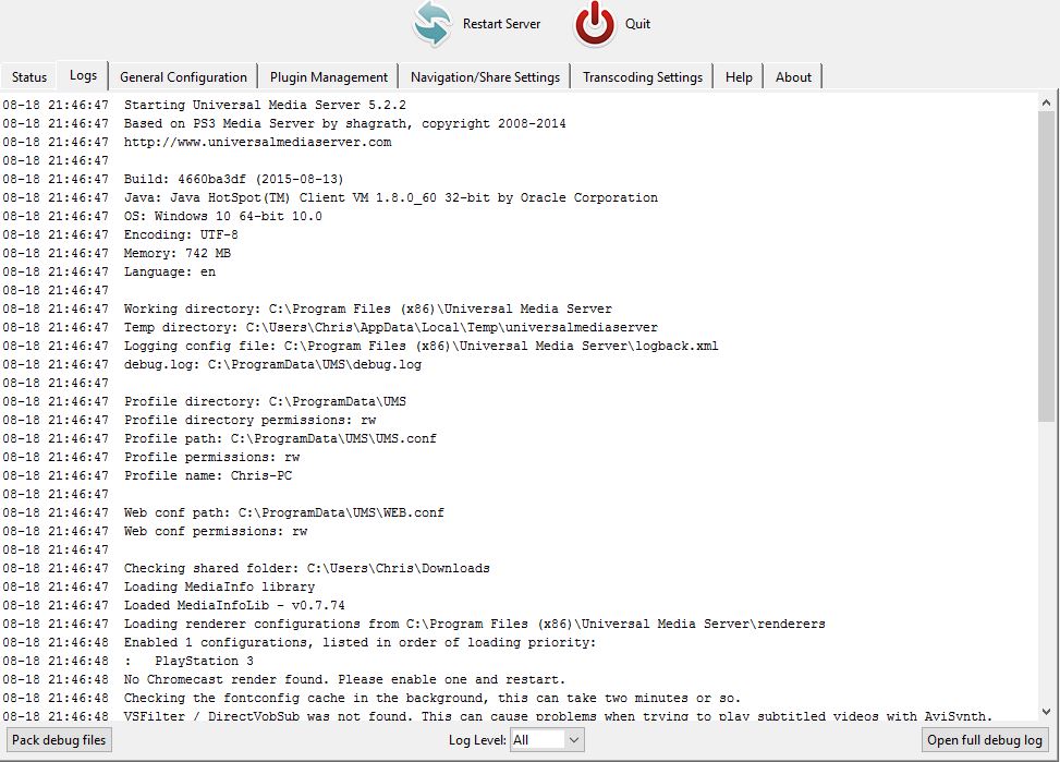

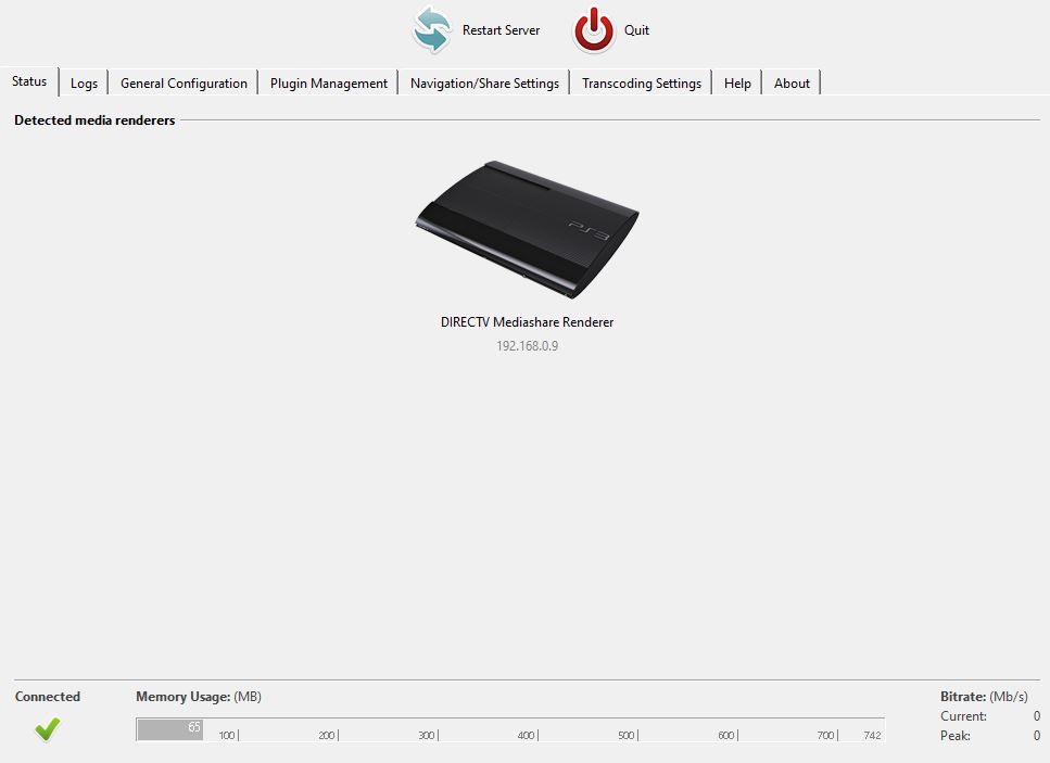

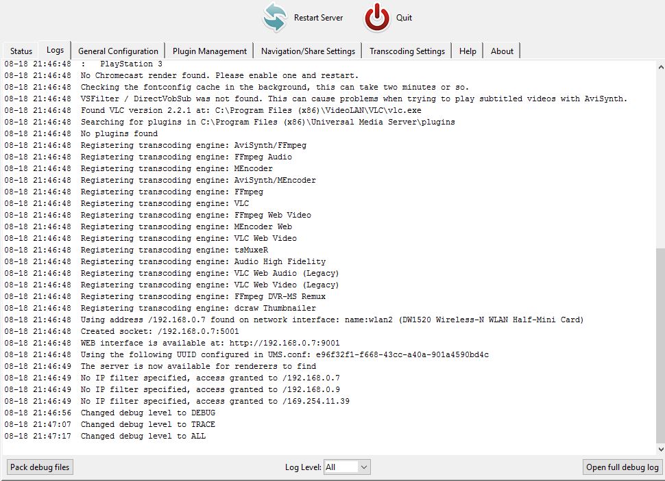

More screenshots
- 6.JPG (134.91 KiB) Viewed 19757 times
- 5.JPG (96.61 KiB) Viewed 19757 times
- 4.JPG (100.44 KiB) Viewed 19757 times

You have "Force default renderer (disable automatic detection)" checked, and you selected PS3 as your default....but in your screenshot UMS is reading your PS3 as Direct TV. Have you tried unchecking "Force default renderer (disable automatic detection)" and leaving default as Unknown renderer?
Re: Widnows 10
No the PS3 picture is the picture but it's still DirecTV. I made it where it will show whatever renderer it picks up as a PS3 picture bc that's the setting I had when it was working so I didn't bother to change it to make it show what is actually there. It wouldn't matter if an XBox was connected it would still show a PS3 picture.
