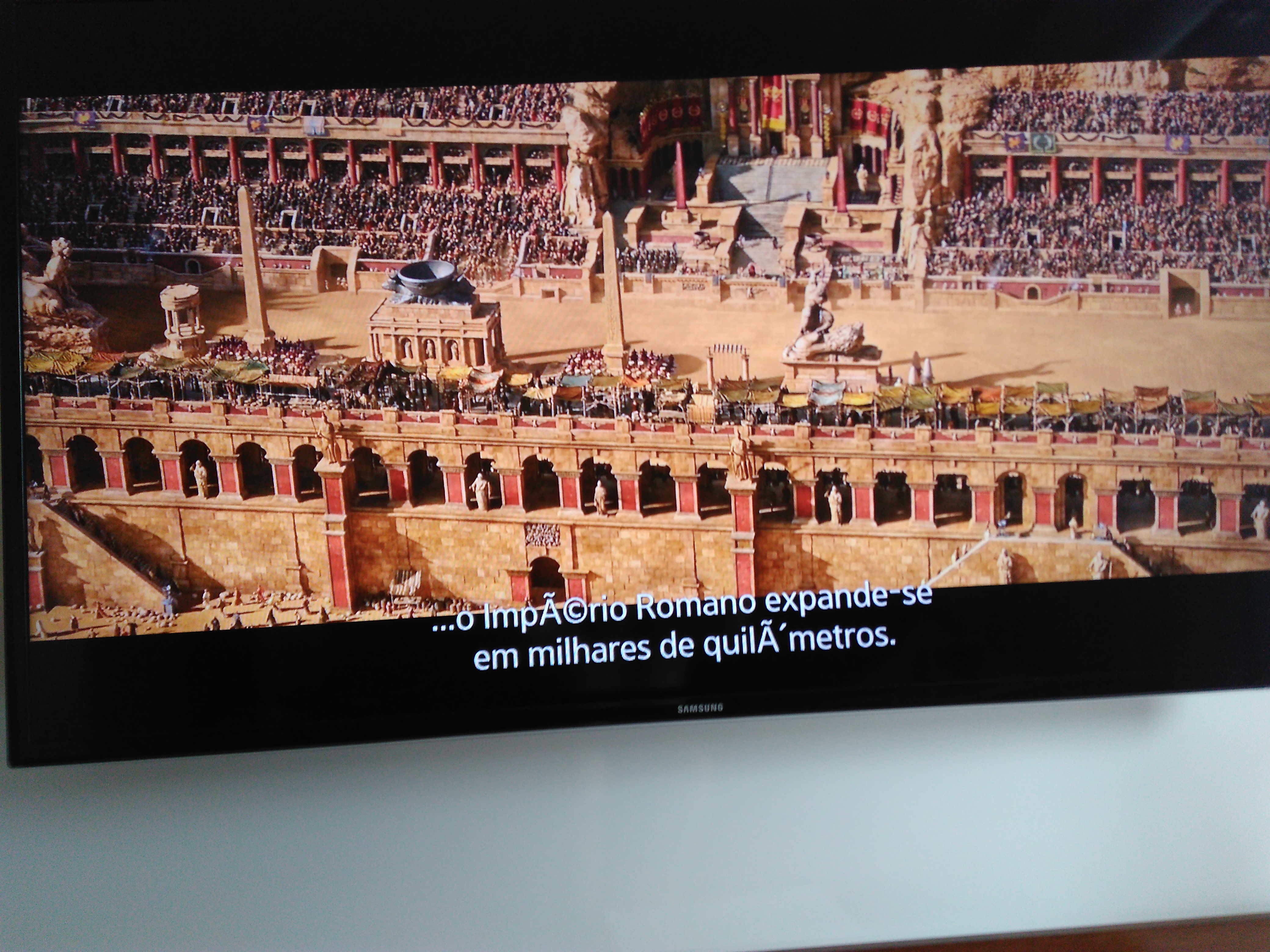

Thanks for the reply! I've corrected the subs priority and seems like it fixed the Gotham one. But I've tested another movie and it is still having problems. (Ben-Hur)Sami32 wrote:Hello eniomarques,

I'm attaching the new trace, the subtitle(added a .txt to the end to attach) and a picture showing the subtitle. I've tried to force an ANSI encoding with Subtitle Workshop, but didn't work.

I think you should change your TV subtitles encoding parameter, between UTF-8 and ISO-8859-1.
I do that myself with some subtitles, as the TV don't adapt/detect to the encoding by itself.

The problem is that the TV doesn't have many encoding options, the only one that fits is the "western europe" option.Sami32 wrote:I think you should change your TV subtitles encoding parameter, between UTF-8 and ISO-8859-1.
You can try to change your Audio/Subtitles parameters as following:As a side note, you should force the Samsung F5900 renderer or adapt it, as it is much more similar to your that the one used by default.Code: Select all
por,off;eng,por;fre,por;und,por;und,und
I've tried the parameter change and force the F5900 renderer, and no luck
A temporary solution is to keep executing such videos thru the transcode folder, but when I do that, the video ends a few seconds before it's real ending with a "check the network" warning. It's not big deal with movies as it usually does in the credits, but for the series I always have to watch the last 30-40s in the PC.

The subtitle #2 worked fine! What was the magic?Sami32 wrote:Using F5900 was only in the purpose of upgrading your native media support, meaning less transcoding so less CPU use, nothing related to your subtitles issue.

No "magic", only UTF-8 file encoding. It's why i told you to change the encoding on your TV.
What the others Samsung users reported:
Press Tools->Subtitle settings->Encoding when you play a video with subtitle
EDIT: Add this line in your renderer configuration profile:
RemoveTagsFromSRTSubtitles = false

Looks like it worked, all my files are playing correctly now, thank you very much for the support and patience!Sami32 wrote:No "magic", only UTF-8 file encoding. It's why i told you to change the encoding on your TV.
EDIT: Add this line in your renderer configuration profile:And try again with your original subtitle file posted here:Code: Select all
download/file.php?id=3683
About the encoding settings in the TV, there's no option for a specific coding, only region like, and I'm with the latest firmware. But again, thanks a lot!
