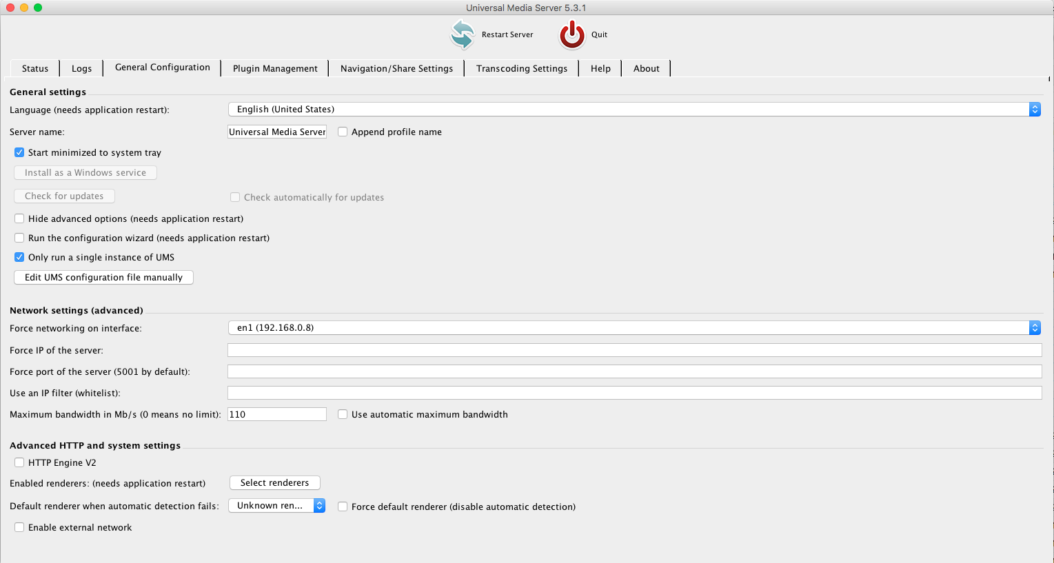

I recently have been plagued by this issue serving from OSX to the telstra t-box and the ps4. The currently playing video would stop and the UMS server would disappear from the media player. This would happen just before 20 minutes. It didn't matter if the file was streamed or served directly to the media player. It also didn't matter if only 5 minutes were played in one video, the issue would present itself just under 15 minutes in to the next video.
I tried modifying settings under general configuration, checking 'only run a single instance of UMS', forcing the network interface, forcing the ip of the server, forcing the port of the server. All of these didn't have any effect.
I've installed and re-installed Java 1.8.0_66 to no effect.
I've had success by removing the line
<string>-Djava.net.preferIPv4Stack=true</string>
from the Info.plist file. I have no idea why removing this works. I thought that because there is a broken pipe error in the logs that it might be network related, that it could be anything from issues with certificates to internal ips to some application conflict on my machine. I also have no idea of what it breaks by removing it, but at least the disconnects don't occur anymore. Anyway I've attached my logs of before and after, so hope they help.
Also after reading https://github.com/ps3mediaserver/ps3me ... /issues/61 here's a screenshot of my general configuration in UMS.
