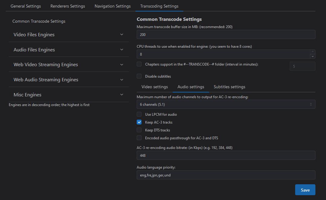

When the videos need transcoding then UMS will use the language options you have set in the transcoding settings. You can set the language priority here
Clipboard Image (6).jpg (57.26 KiB) Viewed 8153 times
There is a similar option for subtitles.
I think the code for Spanish is "es" or "spa" so just put that before "eng" and make sure a comma is separating them.
