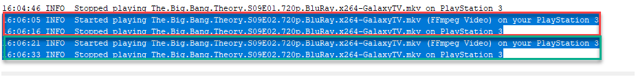

3 - It seems that there is something wrong loading FFMpeg: the first block (red) was pixelating. Then, I went to the #transcode folder and loaded the same video again using FFmpeg (green) and it showed correctly 4 - I changed the first encoder to MEncoder and the issue was fixed.

I'll have a good look into this again later, but I did see a difference in the transcoding command when that video was played.
I'll have to do a bit of experimentation to see if I can reproduce this on my PS4.
Which one was playing normally and which was from the transcode folder?
There was a similar bug I discovered recently where FFmpeg would give an error so this may be related to that.

Re: Too much pixelation after update to 14.3.0
The first attempt was normal and the second was from Transcode.
