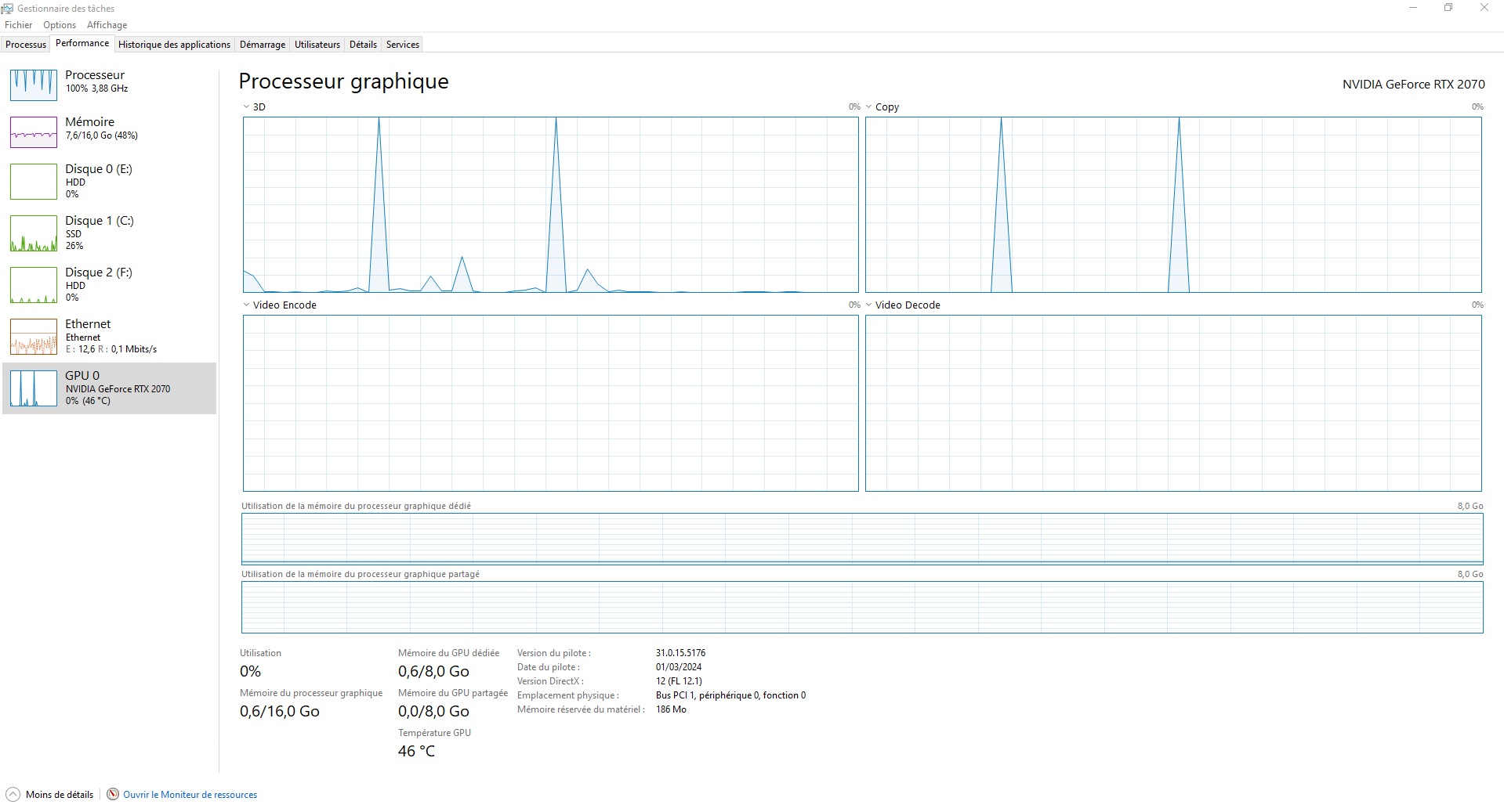

Hello, the network parameter at 0 is saved and the value corresponds well in UMS.conf
I enabled GPU acceleration and defined h264_nvenc (h264) and hevc_nvenc (h265) in the options
I started the video, the GPU is still not used (0%)
CPU: Core I7-2600
GPU: RTX 2070
Ram: 16Go

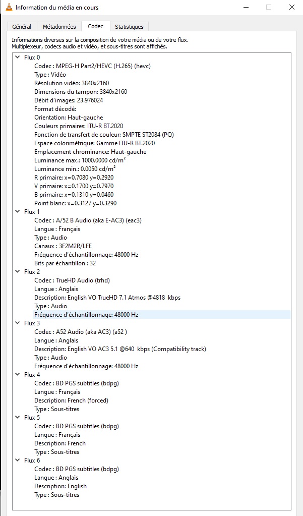

In your previous post you told me that UMS forced transcoding for Avatar because there was TrueHD audio that the television did not support.
The video contains 3 audio tracks:
Stream 1: French E-AC3 (eac3)
Stream 2: English TrueHD
Stream 3: English AC3 (a52)
When I deactivate mkv transcoding the 2 languages are still available and read by the television (Streams 1 and 3)
If several audio streams are available in the same language and the television supports one of them UMS should not transcode, the television supports Stream 1: French E-AC3 (eac3) and Stream 3: English AC3 (a52 )

If at least 1 audio stream is supported then I think the video should be chosen to be streamed but not sure if that check is being done here, maybe something has gone wrong with the decision logic and is choosing to transcode as soon as it see an unsupported audio track.
At least it confirms that TrueHD audio is not supported if you cannot select track 2 on the TV.

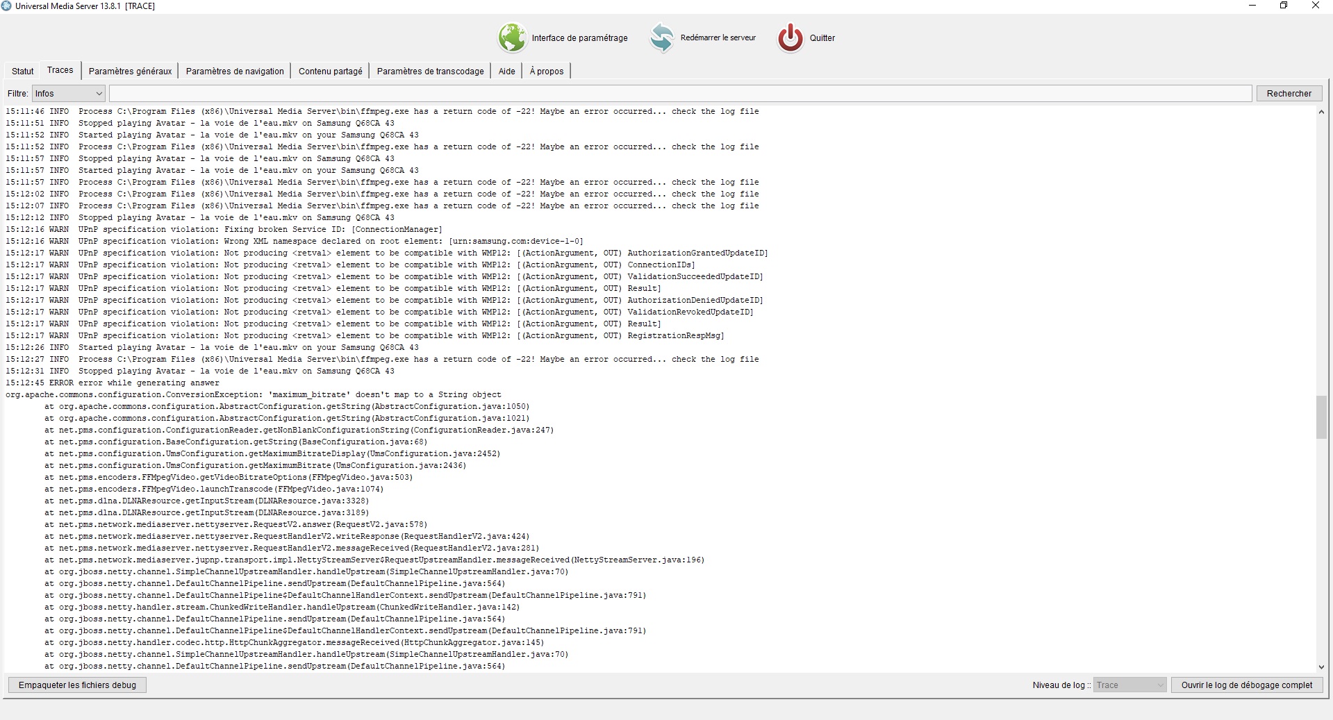

I carried out several tests with the network parameters adjustment (Use the maximum bandwidth, 90 and 0 I realized that in certain cases the video no longer starts, an error is displayed in the UMS logs, when the video manages to play with the settings at 90 or 0, the video was always of poor quality, no change I would say 720p quality or even lower for a 4k video at the input
I carried out another test with the LAN network, it didn't change anything.
Standard error:
ffmpeg.exe has a return code of -22!
'maximum_bitrate
ums_dbg_2024-03-16-15-14.zip
(614.97 KiB) Downloaded 7747 times

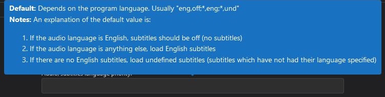

I just realised one thing to why Avatar is transcoding. Your language settings could be making UMS chose to do this.
# Audio/subtitle language priority
# Determine the string of audio language and subtitles language pairs ordered
# by priority for MEncoder to try to match. Audio language and subtitles
# language should be comma separated as a pair; individual pairs should be
# semicolon separated. "*" can be used to match any language. Subtitles
# language can be defined as "off" (e.g. "jpn,off;*,*").
# Default: a localized list (e.g. "eng,off;*,eng;*,und").
# audio_subtitles_languages =
Clipboard Image (7).jpg (3.95 KiB) Viewed 27282 times
Clipboard Image (6).jpg (44.37 KiB) Viewed 27282 times
This is set by default depending on the language used on your computer so I can't see what is actually being used.
As the French subtitles use the PGS format that is not supported on the TV then UMS has to burn then into the video by transcoding.
This setting is not very user friendly so I hope it is something that the devs will improve. They did say they would do it when they moved over to web settings but its probably not a high priority.
I'm guessing if you change it to "fre,off;eng,off;*,fre;*,eng;*,und" it might ignore those subtitles.
If you are not bothered with subtitles you can just disable them.

I do see some errors in the logs now and I don't know why it is happening
net.pms.network.mediaserver.nettyserver.RequestV2 error while generating answer
org.apache.commons.configuration.ConversionException: 'maximum_bitrate' doesn't map to a String object
	at org.apache.commons.configuration.AbstractConfiguration.getString(AbstractConfiguration.java:1050)
	at org.apache.commons.configuration.AbstractConfiguration.getString(AbstractConfiguration.java:1021)
	at net.pms.configuration.ConfigurationReader.getNonBlankConfigurationString(ConfigurationReader.java:247)
	at net.pms.configuration.BaseConfiguration.getString(BaseConfiguration.java:68)
	at net.pms.configuration.UmsConfiguration.getMaximumBitrateDisplay(UmsConfiguration.java:2452)
	at net.pms.configuration.UmsConfiguration.getMaximumBitrate(UmsConfiguration.java:2436)
	at net.pms.encoders.FFMpegVideo.getVideoBitrateOptions(FFMpegVideo.java:503)
	at net.pms.encoders.FFMpegVideo.launchTranscode(FFMpegVideo.java:1074)
	at net.pms.dlna.DLNAResource.getInputStream(DLNAResource.java:3328)
	at net.pms.dlna.DLNAResource.getInputStream(DLNAResource.java:3189)
	at net.pms.network.mediaserver.nettyserver.RequestV2.answer(RequestV2.java:578)
	at net.pms.network.mediaserver.nettyserver.RequestHandlerV2.writeResponse(RequestHandlerV2.java:424)
	at net.pms.network.mediaserver.nettyserver.RequestHandlerV2.messageReceived(RequestHandlerV2.java:281)
	at net.pms.network.mediaserver.jupnp.transport.impl.NettyStreamServer$RequestUpstreamHandler.messageReceived(NettyStreamServer.java:196)
	at org.jboss.netty.channel.SimpleChannelUpstreamHandler.handleUpstream(SimpleChannelUpstreamHandler.java:70)
	at org.jboss.netty.channel.DefaultChannelPipeline.sendUpstream(DefaultChannelPipeline.java:564)
	at org.jboss.netty.channel.DefaultChannelPipeline$DefaultChannelHandlerContext.sendUpstream(DefaultChannelPipeline.java:791)
	at org.jboss.netty.handler.stream.ChunkedWriteHandler.handleUpstream(ChunkedWriteHandler.java:142)
	at org.jboss.netty.handler.codec.http.HttpChunkAggregator.messageReceived(HttpChunkAggregator.java:145)
	at org.jboss.netty.channel.Channels.fireMessageReceived(Channels.java:296)
	at org.jboss.netty.handler.codec.frame.FrameDecoder.unfoldAndFireMessageReceived(FrameDecoder.java:459)
	at org.jboss.netty.handler.codec.replay.ReplayingDecoder.callDecode(ReplayingDecoder.java:536)
	at org.jboss.netty.handler.codec.replay.ReplayingDecoder.messageReceived(ReplayingDecoder.java:435)
	at org.jboss.netty.channel.DefaultChannelPipeline.sendUpstream(DefaultChannelPipeline.java:559)
	at org.jboss.netty.channel.Channels.fireMessageReceived(Channels.java:268)
	at org.jboss.netty.channel.Channels.fireMessageReceived(Channels.java:255)
	at org.jboss.netty.channel.socket.nio.NioWorker.read(NioWorker.java:88)
	at org.jboss.netty.channel.socket.nio.AbstractNioWorker.process(AbstractNioWorker.java:108)
	at org.jboss.netty.channel.socket.nio.AbstractNioSelector.run(AbstractNioSelector.java:337)
	at org.jboss.netty.channel.socket.nio.AbstractNioWorker.run(AbstractNioWorker.java:89)
	at org.jboss.netty.channel.socket.nio.NioWorker.run(NioWorker.java:178)
	at org.jboss.netty.util.ThreadRenamingRunnable.run(ThreadRenamingRunnable.java:108)
	at org.jboss.netty.util.internal.DeadLockProofWorker$1.run(DeadLockProofWorker.java:42)
	at java.base/java.util.concurrent.ThreadPoolExecutor.runWorker(Unknown Source)
	at java.base/java.util.concurrent.ThreadPoolExecutor$Worker.run(Unknown Source)
I tried to replicate on my computer as I had a hunch a what it might be but did not get it to happen. It may have been that bug I mentioned that is fixed in the V14 beta I am using though. Try deleting the value in the "Maximum bandwidth in Mb/s (0 means 1 Gb/s):" and UMS will use the default value of 90 when this is blank.
You can also check the UMS.conf to make sure it shows
maximum_bitrate =
It could also be what is causing the error code from FFmpeg
