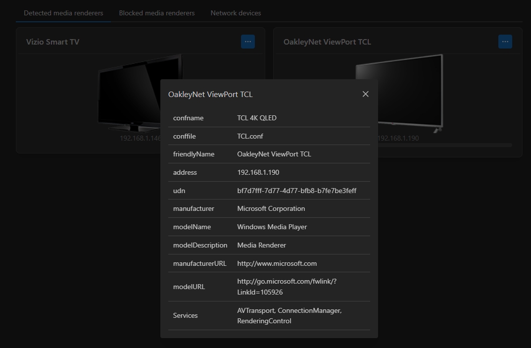

The Transcode "folder" actually shows as a "Settings" gear icon, when I click on it then the movie is already there...
I didn't copy anything into anywhere except the new TCL.conf into the Renderers folder, and Yes the TV shows with that.
2025-03-02 13 44 07.jpg (117.29 KiB) Viewed 5152 times
Yes the file names do show the Subtitle info - I hate that.

OK it is good that UMS is picking up the right conf now for the TV.

Your TCL TV is
Matched media renderer "TCL 4K QLED" based on dlna details "OakleyNet ViewPort TCL 192.168.1.190 bf7d7fff-7d77-4d77-bfb8-b7fe7be3feff Microsoft Corporation Windows Media Player Media Renderer http://www.microsoft.com http://go.microsoft.com/fwlink/?LinkId=105926"

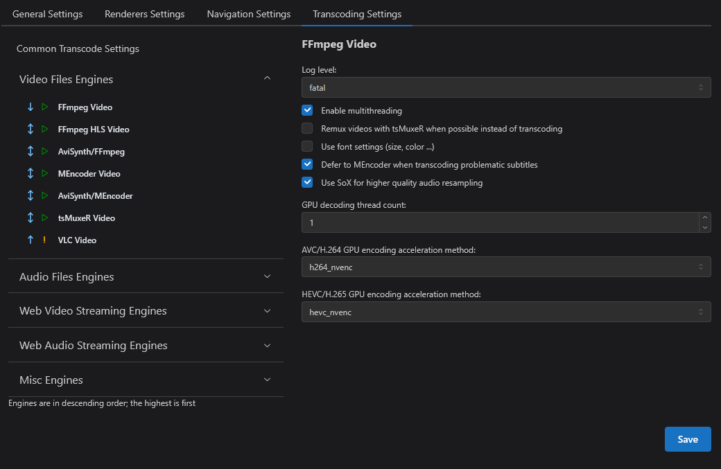

Screenshot 2025-03-04 163538.png (49.13 KiB) Viewed 4967 times
Screenshot 2025-03-04 171257.png (20.3 KiB) Viewed 4967 times
The engine name will either be [FFmpeg] or [FFmpeg HLS Video] as that is what is used to do the transcoding. There are other engines like Mencoder that are useful for certain formats but won't do HLS. If you see an engine name then it shows that the video will be transcoded and not streamed.
As the video is being transcoded the TV will show the format as a .mpg so this is correct, this is the format of each video chunk sent to the renderer.
That warning can be ignored, UMS is just looking for a service that does not exist so the device responds as bad request.
The videos with internal subtitles should be working properly and you should be able to turn on the subtitles on the device or the web player like you confirmed with that test video I asked you to try. Remember that the sub button on the remote may not turn these on and there could be some other control for the player like I found on my Samsung TV.
Could you upload the "6 Underground (2019).mp4" video and subs to somewhere like mega.nz so I can test this on my TV, best to PM me the link.
Does this video have internal subs, if so you should be able to turn them on somewhere on the TV as this is being streamed unaltered.

It is surprising that internal subtitles don't show. As I know nothing about Roku devices I checked around to see how to turn them on.
Apparently you have to enable them in the accessibility menus before you can turn them on, then you can use the star button on the remote to turn them on or off.
This is not very user friendly so I can understand how you could not turn them on. This is the video I found showing how to turn them on and this is the page on Roku's support site. Try it and see if that test video will show subs.
I also found that TCL is Roku so those confs I made for it are not much use, especially as you are using a separate Roku device anyway. But in the last logs I did see it was being used and the "underground" video was being streamed and appeared to have internal subs so you can use that for testing
I also saw the formats they are supported by Roku and I see why it made sense to only use HLS for everything.
I could probably have a go at adding more supported formats to the conf so transcoding is not needed for the few it will play natively if you are willing to test as this is something I'm unable to do.
I could also get one of the old confs that do not use HLS and you could try that but it probably won't be a good experience, and with the broken transcode folder you would not be able to select the right subs if UMS picks the wrong one but at least the subs will be burnt into the video.
I think casting is working as this is basically the same as transcoding the video and burning in the subtitles. The year in the filename makes no difference.
As the transcoding format is HLS then it has to use FFmpeg even if VLC is a higher priority on the engine list.
If a video has internal subtitles it will not show them in the filename as they can be enabled on the device, unless UMS is burning one of them into the video.
