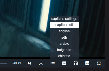

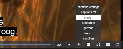

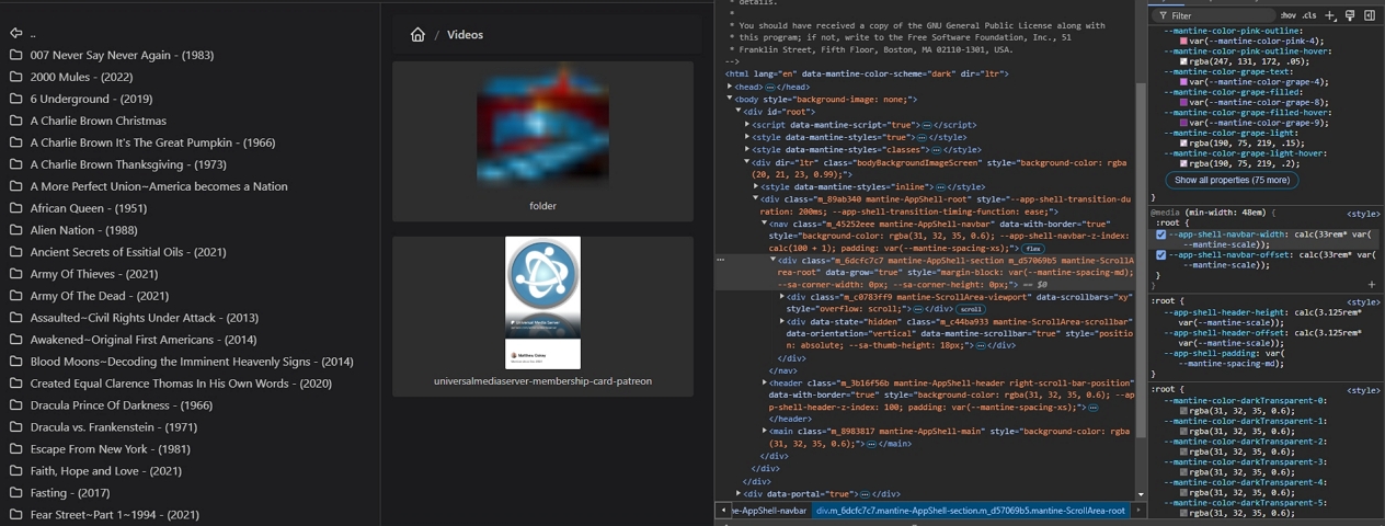

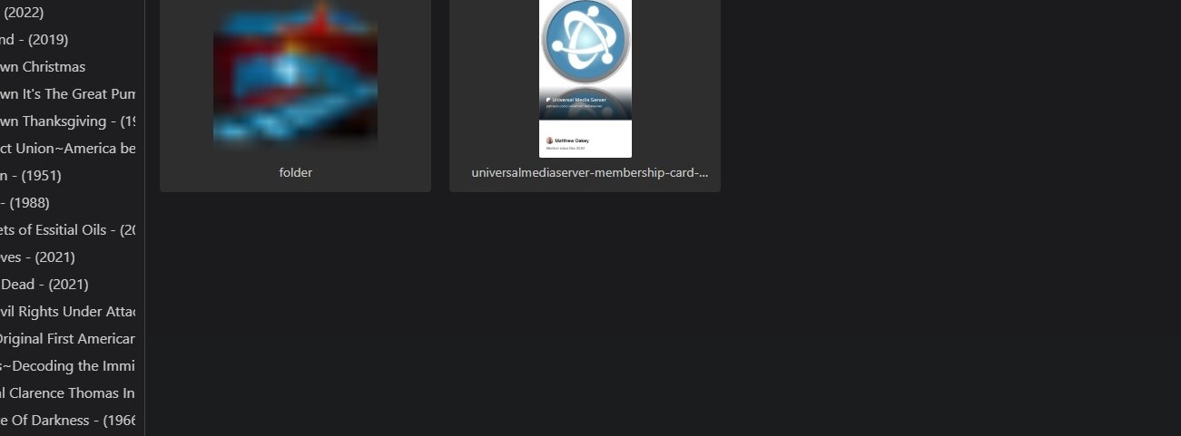

Subtitles also do NOT work when just using UMS in a local browser !!! NO control to activate, access, turn ON or OFF.
On TVs, there is NO selection of Subtitles available - they either show or NOT.

My "webplayer does NOT show all the controls your pic shows above ... notice NO control for Subtitles ...

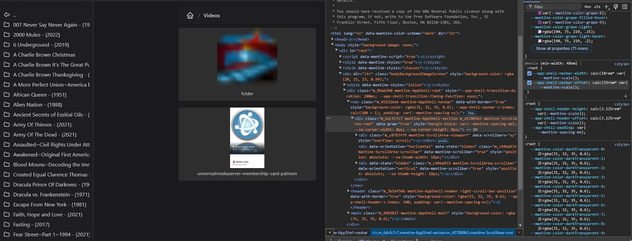

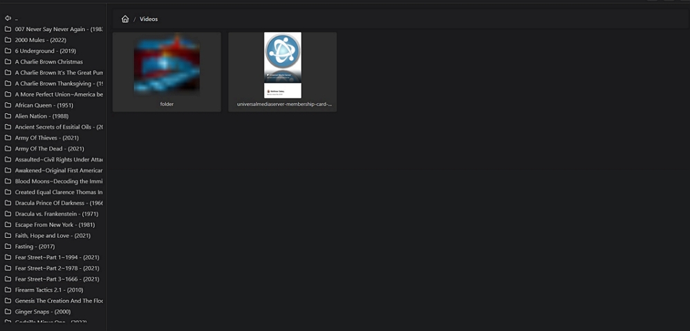

On another note ... I have asked - for years - for the "column separator" for Titles {media} to be extended to at least 500 {it is set/calculated at 300 currently} because the scroll left and right in that column is a nuisance to grab for my old eyes and fingers. I would prefer NO scroll bar at all, and extra space at the bottom so titles don't get cut off. Each time I access this directory to search for a title to play, I have to go into "Inspect" in Chrome and change settings for the page to make that column wider TO SHOW ALL THE TITLES THAT ARE LONGER THAN WHAT IS ALLOWED TO SHOW. It would be nice if at least THAT vertical line separating the areas on the page was made to be "grabbed" and moved with the mouse pointer, but I would prefer it to be hard set at that 500 for me, MAYBE a setting could be added in the Config file to "hard" setoption for width, once, by the individual user.![Image]()

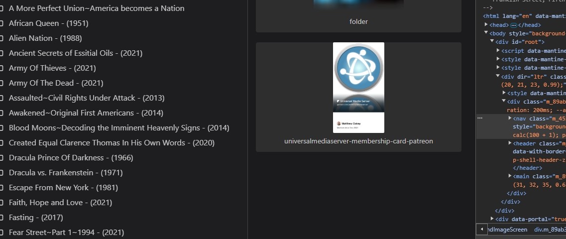

Also just noticed that NOW, in v14.10.1, after I change those settings I mentioned above - they NO LONGER PERSIST after I close the "Inspect" window ... the column returns to being too short to show entire media titles.
Forum would not allow a fourth pic to show edits ... and those pics showing at the bottom are in the wrong order in "Preview" anyways.
pretty stupid that the most common subtitle file {.srt} is not able to be used from the start by UMS... just sayin'.
I did the update to 14.10.1 and NOW NONE of the movies will play through Roku Media player, or starts playing for about 3 seconds or so, buffers for a few minutes producing an error : "NO Valid bitrates"
And that "Compressing debug.log ..." is still happening - now every 45 seconds.
I have rebooted my computer, the Roku, the TV, my Router ... no change - and No movies.

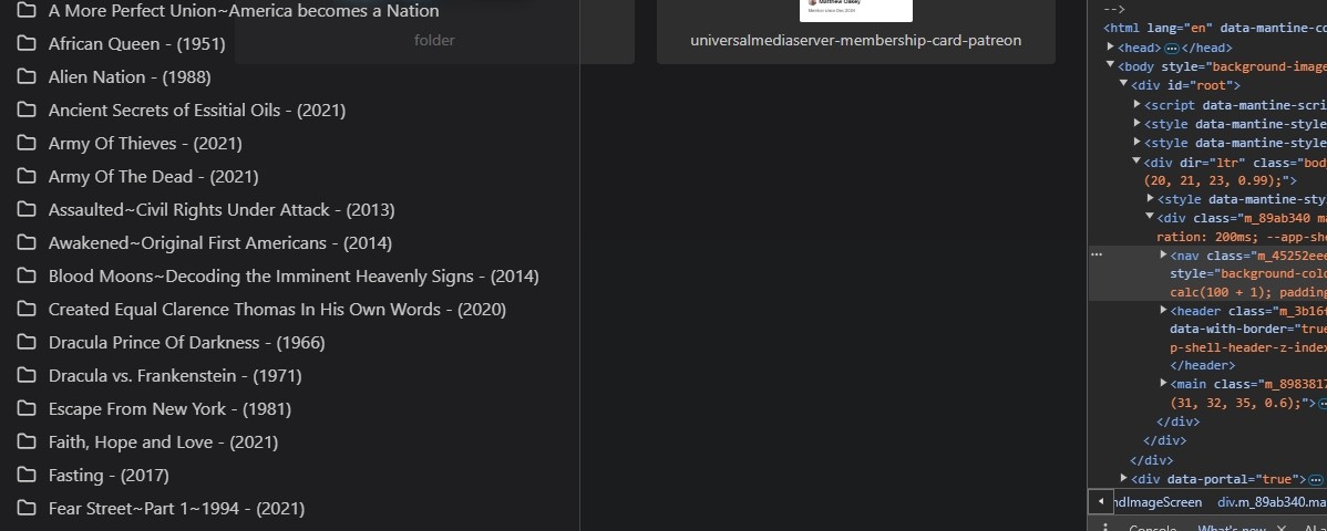

AND, above, the small pic of the Controls area of the web player is showing 3 times, and I only have it to show once up top in the post.
Here is the third pic of the code ... And I now notice that the pics are being cut off the left and right, not showing everything I am uploading ...

Try this ...
- 2025-02-17 11 32 01.jpg (97.58 KiB) Viewed 7890 times
- 2025-02-17 11 37 15.jpg (371.28 KiB) Viewed 7890 times
- 2025-02-17 11 40 08.jpg (370.51 KiB) Viewed 7890 times

I split the topic as this seems like a separate issue.
That video you tried must not have had internal subs or multiple audio tracks so would not show those options.
Try the test5.mkv video from here and this should work.
Use download raw to get it. I just tested it and all the controls and subs appear for me. This will at least confirm subtitles will work if internal.
