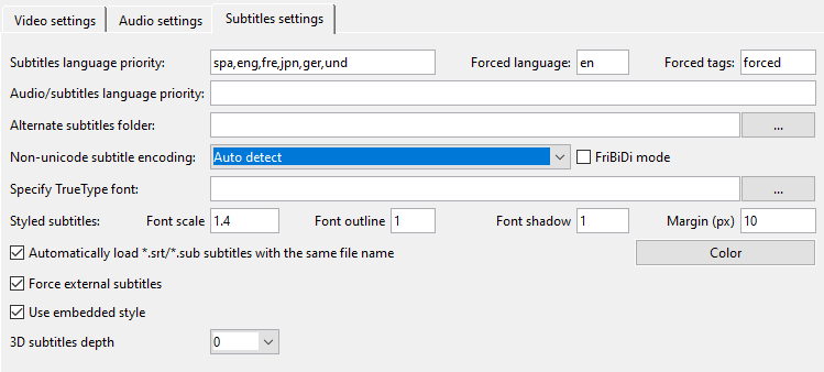

Once again another thread about subtitles. I have sifted thru the previous threads and still running into the same issue. What I want is spanish subtitles to come thru UMS, I am using an LG smart TV thru DLNA and the attached settings.
What is happening is the following: the only way the subs are coming up is when I play the "resume movie" but I want them to work since I play the beginning of the movie. I disabled the resume function in UMS and then the subs don't work. The subs are in an .srt file that I named exactly the same as the movie file so in the movie folder there are two files: movie.mp4/mkv/avi and movie.srt. Also there aren't any subs embedded in the movie file itself. Any help would be appreciated it, thank you for looking.

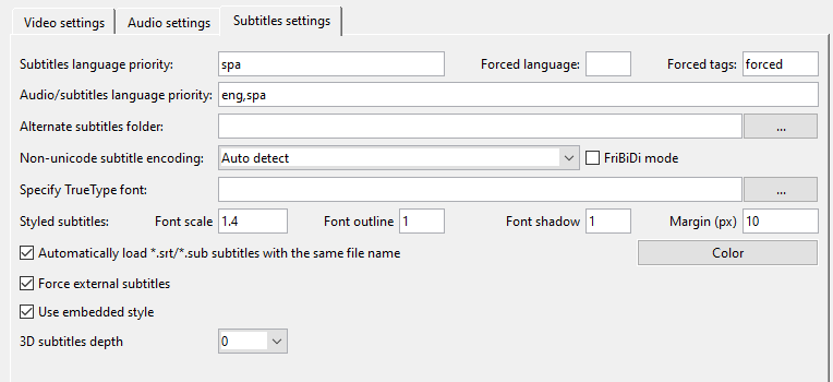

I changed it to this and still not working. The only way they work is when I enable the resume function and play the resumed file. It's very annoying because I want to get it working since the beginning. Thanks
