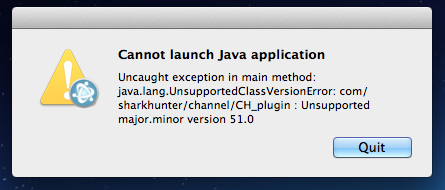

More Java issues
I just installe UMS for the first time tonight. It opened with no problems on first execution. Now I get an error. See attachment.
- Screen Shot 2014-07-17 at 1.32.38 AM.png (42.56 KiB) Viewed 20292 times
