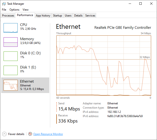

When I play 4K without transcoding, the movies 4K movies are stuttering badly.
In order to see where the problem could be, I copied the same movie on an external SSD and connected it to the TV directly, via USB. The movie played ok, no issues, so the TV is not the problem.

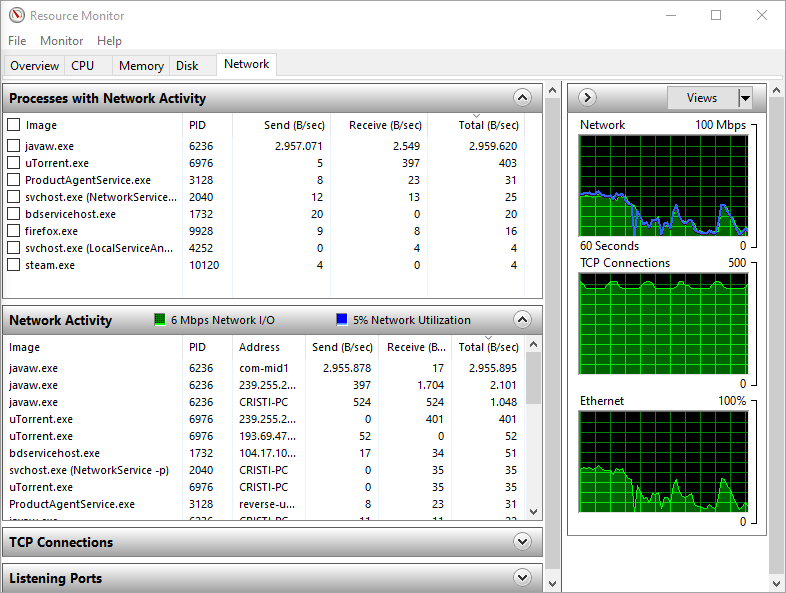

Next, I opened the task manager and resource monitor on my PC. As you can see in the file
, the CPU is very low and the network upstream traffic goes up to 40 - 50 Mbps maximum.
The resource monitor also looks good.
In conclusion, all the resources of my PC are not used at maximum capacity or they don't look so.
The TV plays the video just fine from a direct USB device.
I suspect the network but I don't know how to investigate deeper.

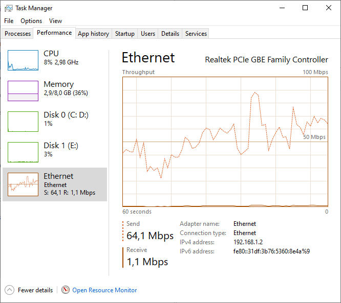

It seems that the problem was the wireless connection.
After connecting the TV with a network cable, 4K movies are playing as expected.
A 4K video, encoded with HEVC (h.265), can reach up to 80 - 90 Mbps.
