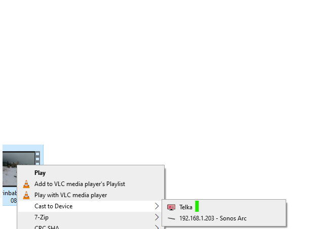

Try to cast the file directly (if you have Windows). Do you have the same problem?
- Screenshot 2022-09-03 114130.png (17.63 KiB) Viewed 3245 times
