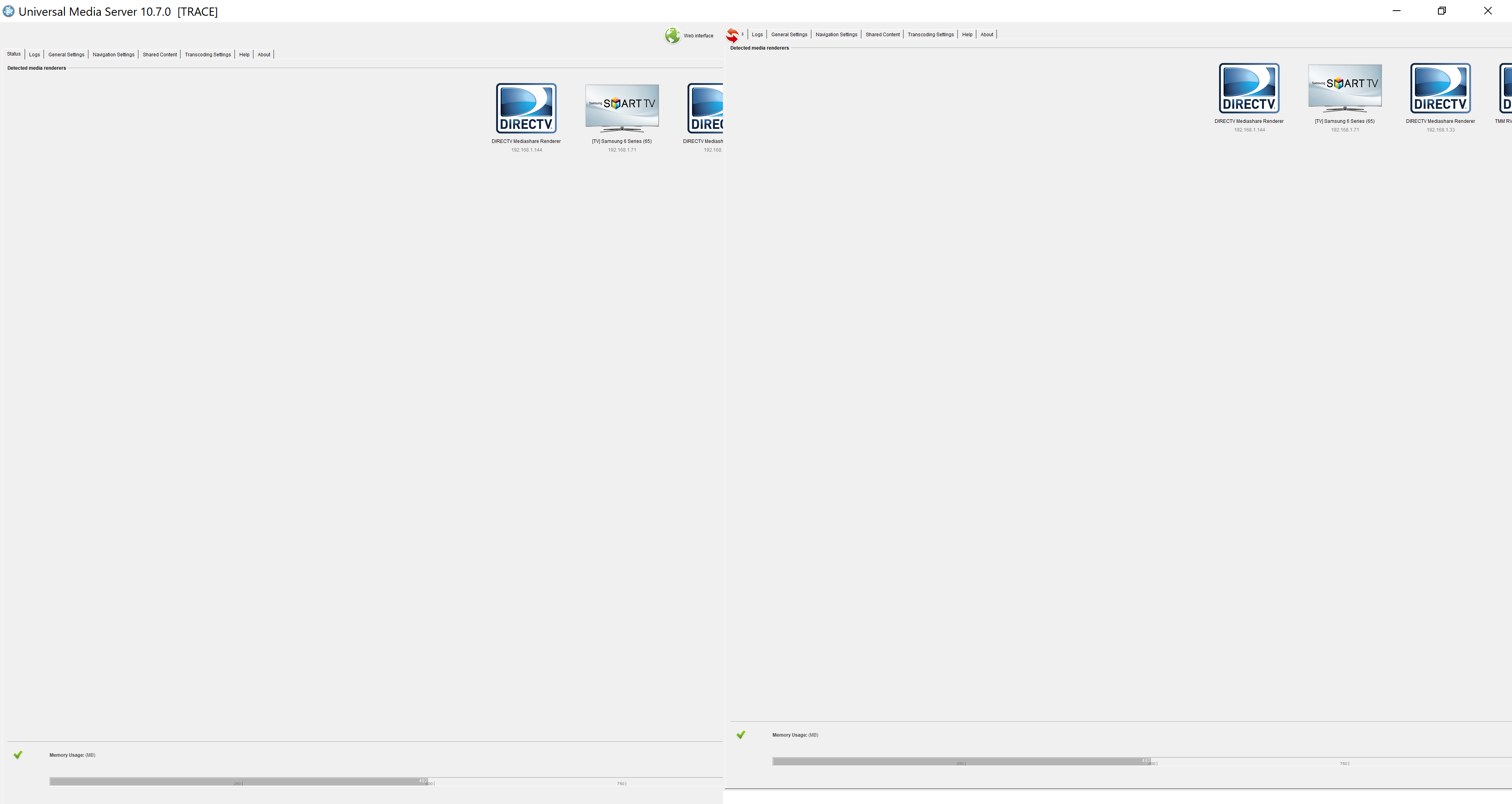

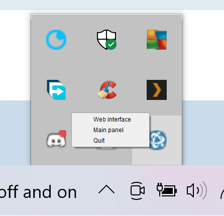

I can't get the bug to happen again because now the app is just not connecting with my TV at all, even though it appears in the status window. I'm also experiencing a lot of weird interface hiccups which I screencapped, and as I captured in the last file, the DPI has gone crazy since this update (I'm using an A-51 with Win10 and I've had these DPI with other programs, but not with UMS until 10.6)

Post by Rodney Razorshorts »
Screencaps of aforementioned issues with interface
and DPI
Thank you for your patience while I slowly respond, I really appreciate it.
