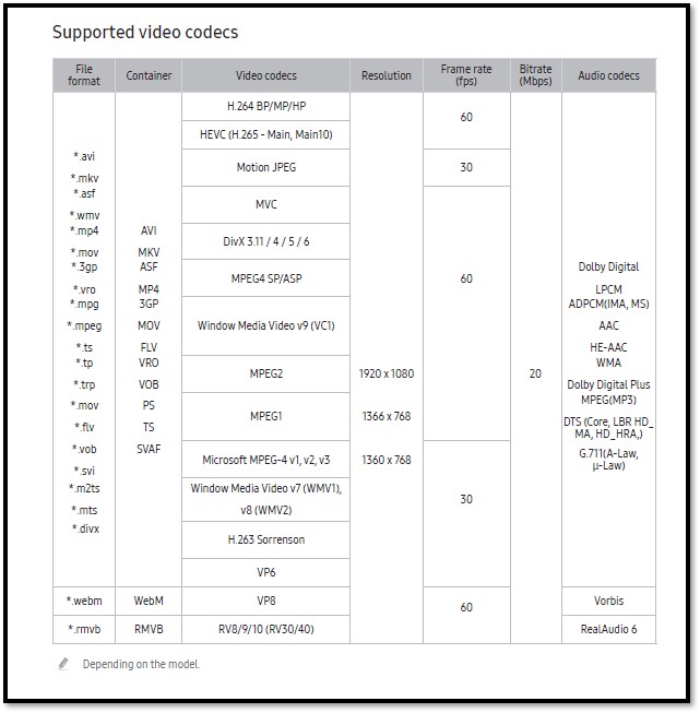

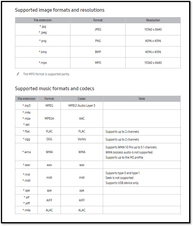

I have the spec sheets from the manual for one of my Samsungs
I also have the GetProtocolInfo from a debug log (someone told me how to) attached. This is a piece and it seems to use different terms and I have no idea how to read it or what to do with FLAGS
This is the supported format sections from the conf file that I'm using (attached). The DefaultRender.conf file has a complete list and a good explaiation
My problem is that the Samsung spec sheets use different terminology for most of the codecs.
Is there a translation available or could someone give me a hand?
