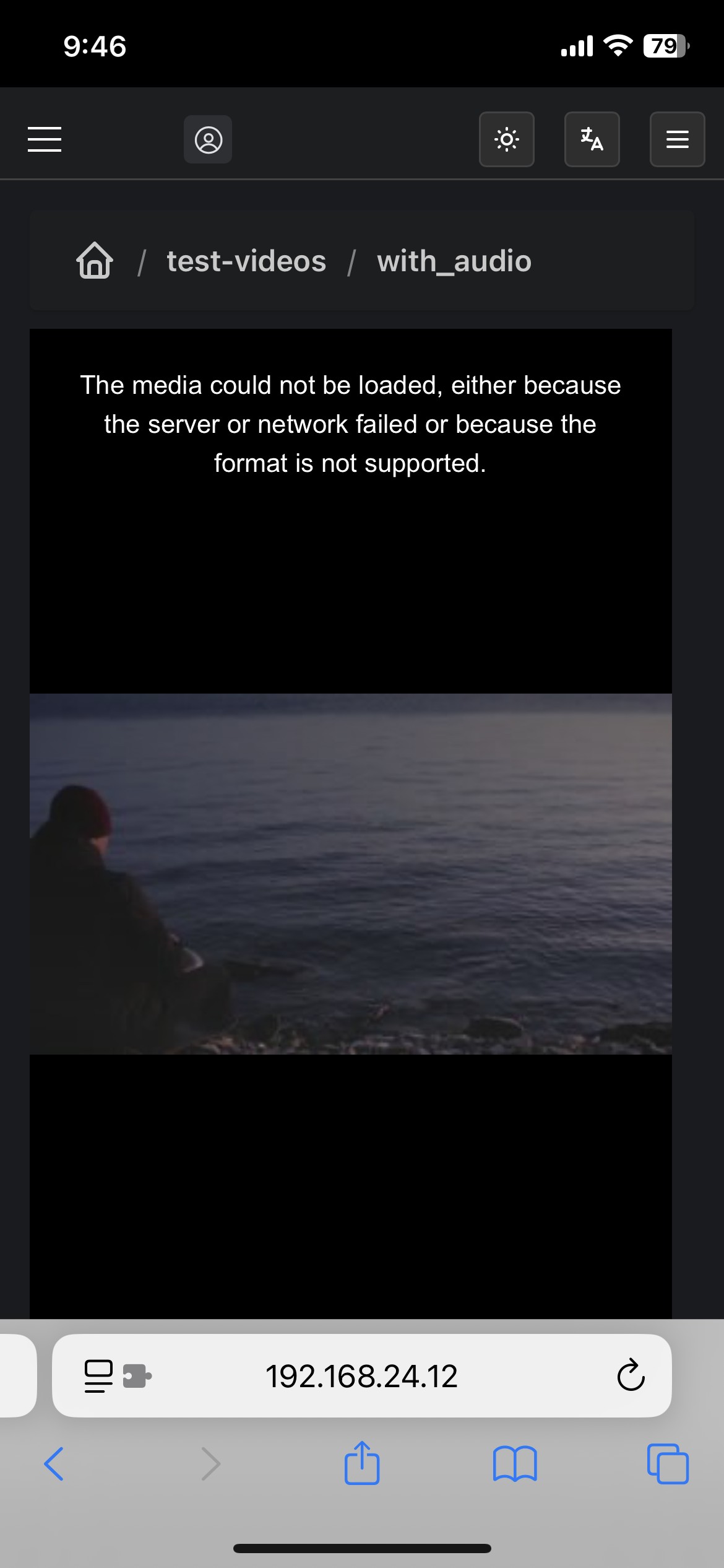

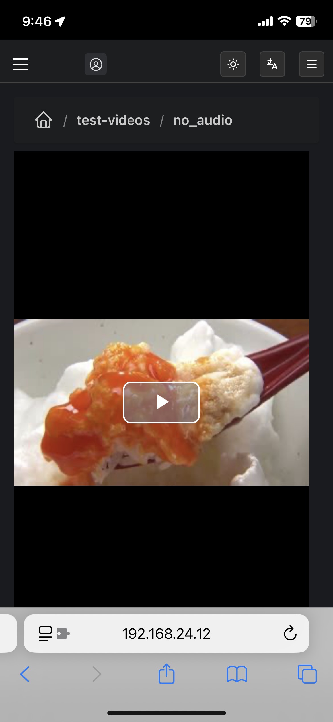

I think that on iOS, videos without sound can be played, but videos with sound cannot be played.
I will post the log.
Server: Windows 10 Pro x64
Client: same as above and iPhone 12 Pro iOS 18.3.2

@nyanko_wanko I could not see anything odd in those logs. Do these work fine on another computer running windows or Linux? Have you tried another browser? I'm not sure options there are for iOS besides Safari.
Could you upload those 2 test files so I can try them on my computer so I can compare the logs. You can use something like mega.nz and probably best to PM me the link.
The devs have Macs so in theory it should be working unless there is some incompatibility with the iPadOS version.

Re: Web player failing for iOS/iPadOS
@mik_s No problem with Google Chrome on Windows.
On iOS, all browsers run on WebKit, so there seems to be no other choice.
I upload 2 test files to mega.nz. And send you the link via PM.
