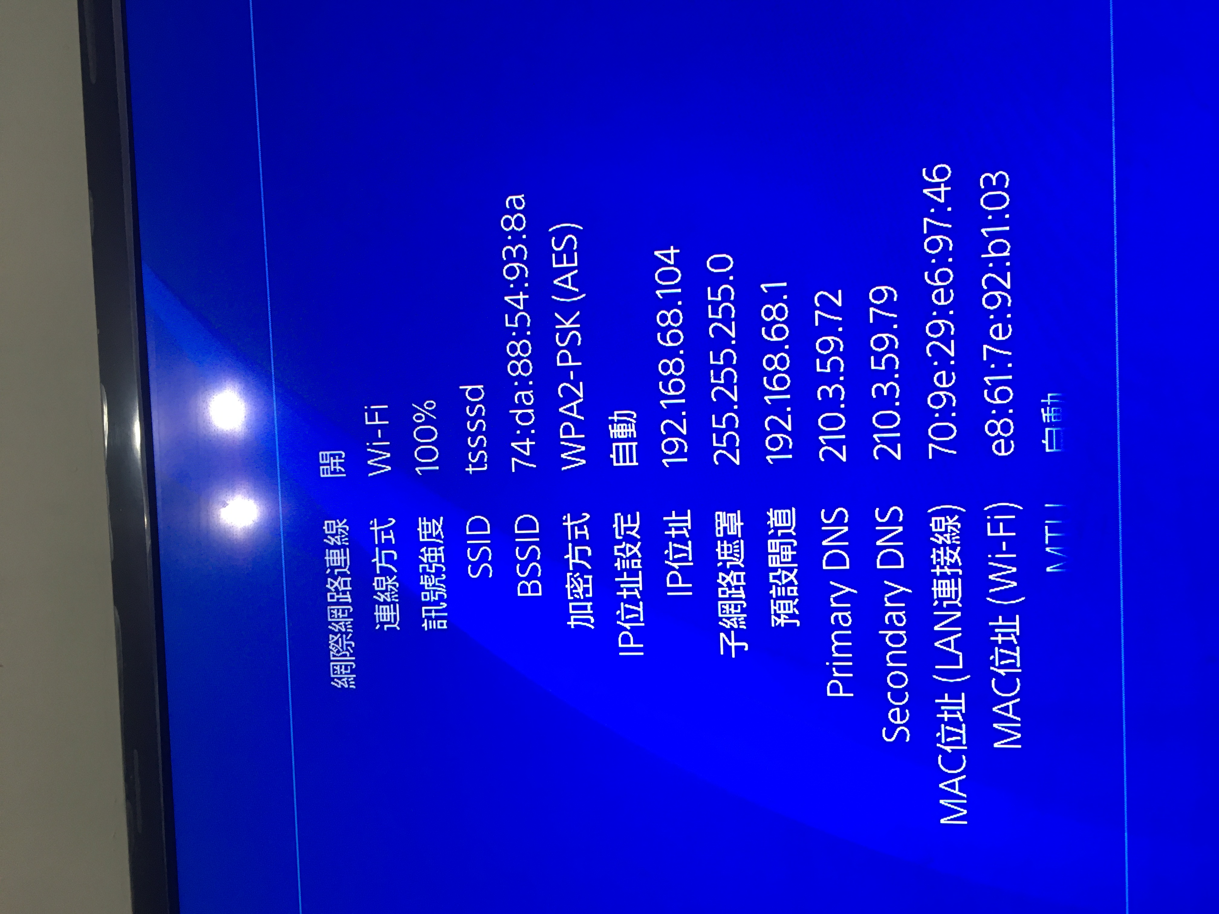

And I found that my PS4’s IP is start with 192
I’m confused
I’m not quite sure what is DMZ lol
I’m confused

Re: my PS4 won't show on UMS
There is something wrong with your network setup.
Your PS4 has an IP of 192.168.68.104 and using the gateway (Router LAN address) of 192.168.68.1
That seems normal.
But... Your computer has an IP address of 113.254.xx.xxx which is HGC Global Communications in Hong Kong which is most likely your ISP.
That is definitely not correct.
Your computer should be on the same subnet as the LAN IP of your router (like the PS4). EG: 192.168.68.*
It could be some setup in your router or perhaps your computer network adapter has a manual setup and not setup to get an IP by DHCP from your router.

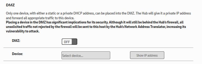

Just had my internet go down so was looking at my router's settings to see why and saw this in the firewall section.
See if you can find anything similar in yours and make sure it is turned off.Logs are important for us to help, Please follow This Link before asking for support. Just a forum cleaner, Will help if I can but no expert.
