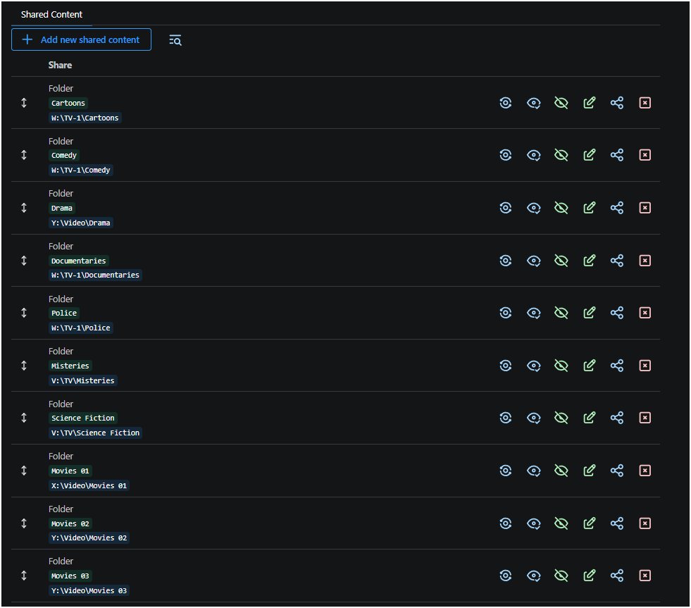

Hi all,
I looked for this issue here but could only find old posts that didn't help, so now I hope someone here can.
I have been having this issue for a looong time, actually, since PMS became UMS, but it's been bugging me more because Windows 11 restarts too much. When the server restarts I lose all videos marked as played. I have the shares all checked:
I appreciate any help.
Thank you!
Thank you!

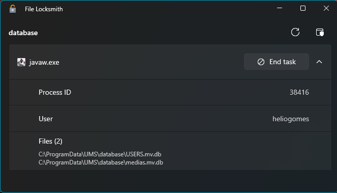

Sorry for taking so long, but here is the last update.
I logged off the other user to prevent any interference.
Now, when I quit UMS, the C:/ProgramData/UMS/database/ folder is still locked, even though I can't find any instance of UMS or javaw.exe anywhere on Task Manager - processes or services. When I check on Locksmith it says that the folder is locked by javaw.exe under my user But again, I can't find it anywhere. Shouldn't this be finished when I quit UMS? Could this guy be the culprit: C:\Program Files (x86)\Java\jre1.8.0_321\bin\javaw.exe? I found references to this file in my registry.
One more thing: when I restart my computer and log in to my user, UMS starts automatically via a shortcut on my startup folder and the web settings page opens, but when I quit and load UMS again (without restarting the computer) it doesn't, so I'm assuming UMS isn't quitting completely unless I restart the computer.
