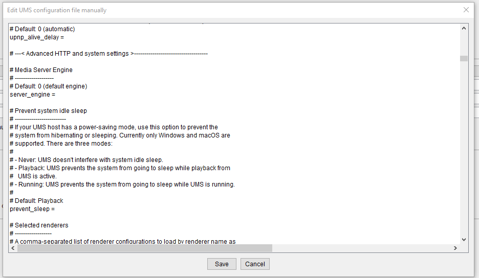

There is some settings to prevent sleep while UMS is running or during playback that might help. It is currently set to not sleep during playback as default.

I thought this could be set in the web settings but it is missing for some reason. It is still in the old GUI though. I'll have to mention it to the Devs.
# Prevent system idle sleep
# If your UMS host has a power-saving mode, use this option to prevent the
# system from hibernating or sleeping. Currently only Windows and macOS are
# supported. There are three modes:
# - Never: UMS doesn't interfere with system idle sleep.
# - Playback: UMS prevents the system from going to sleep while playback from
# UMS is active.
# - Running: UMS prevents the system from going to sleep while UMS is running.
# Default: Playback
prevent_sleep =
