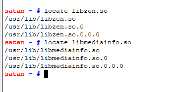

I think this is one for @Subjunk as I can't see anything obvious.
It does confirm the libzen problem does not exist in 14.11.0 so I am suspecting that, and this error appears just before the out of memory error, but don't know how it could be causing the memory error when your TV is turned on.
does /usr/lib/libzen.so and /usr/lib/libmediainfo.so exist on your computer? or are there is another location?
I tried looking though the source files for these but could not find them.

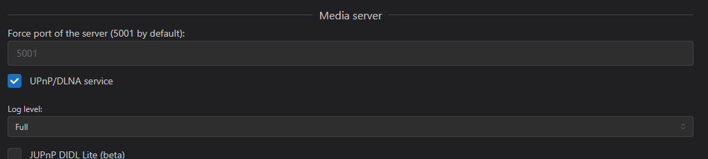

These recent versions do filter out a lot of the logspam about how UMS is communicating with a device but maybe this has the information needed that points to the problem.
Try changing the Media server log level to Full and see it that reveals anything in 14.12
Re: OutOfMemory Error
libzen.so and libmediainfo.so are both located on my server.
The path for both is: /usr/lib/ I will try 14.12.1 again with the log level set to FULL - Did you mean FULL or ALL?
I tested full but this is different from the normal log_level.
I don't know what setting it changes in UMS.conf, I'm not sure it is even in here and may be some log configuration file.
This is the first time I tried it but it did show more in the logs.
I think the path to those libraries may be messed up in 14.12 if they do exist but cannot be found.
Maybe the wrong version for your CPU or OS architecture was added to that Linux build.
You could try and back them up from 14.11 then restore them after installing 14.12 to see if it makes a difference.
This is probably still referring to the old Java GUI, I don't think there is a way to set this in the web UI except to put into trace mode for making logs.# This property can also be set from the 'Logs' tab in the gui.
"I think the path to those libraries may be messed up in 14.12 if they do exist but cannot be found. "
My feeling is that this could be the issue.
This line from the logs (V14.12.1):
Suppressed: java.io.IOException: Native library (linux-x86/libzen.so) not found in resource path (update.jar:ums.jar)
Indicates that UMS is looking for "libzen.so" in some folder named "linux-x86" but there is no "linux-x86" folder.
The path for libzen.so is "/usr/lib/libzen.so".
"Maybe the wrong version for your CPU or OS architecture was added to that Linux build.
You could try and back them up from 14.11 then restore them after installing 14.12 to see if it makes a difference."
I'm not sure what you are suggesting that I back up.
Can you give me more information?
