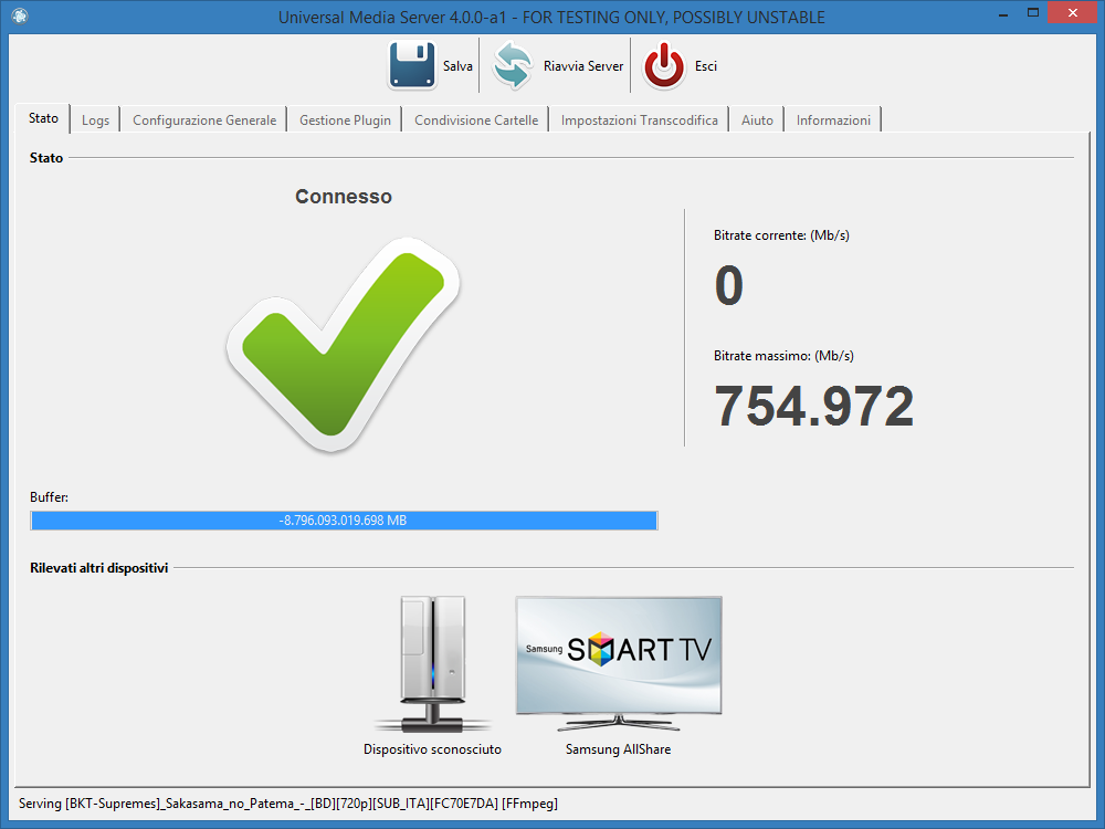

Thanks a lot! Don't know if it can help, but when the TV is loading, UMS shows this "peculiar" number for buffer size. I took a screen 'cause the negative number was quite strange to see.
- Cattura.PNG (93.09 KiB) Viewed 18680 times

Samsung T27B750EW. What's really strange is the behaviour of the buffer counter and the fact that with PMS everything works fine.

I understand, let me take a better look and i'll get back to you. I've had the negative counter as well

I have the exact same issue - choose transcode, choose a engine/format, there is a longer than usual delay then I get "Check Network Connection" and I am dumped back to standard TV. Buffer is massive negative value as well.
