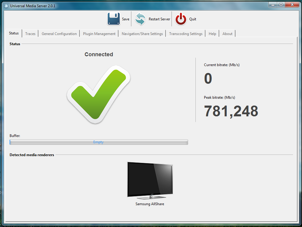

Strange thing: in my status tab in UMS I see a peak bitrate of 781 Mb/s. There I can see it found my TV without issues, but when I tried to play the vids above my TV loaded for a while then disconnected from UMS.

I've attached the debug information, a mediainfo of the the file and a screenshot of UMS.
First, played the files without the #transcode folder, with the same results of Samsung's Allshare DLNA Server (xvid and avc 4.1 8 bit work very well).
Then, I went to #transcode folder and tried to transcode the xvid file without success.

- screenshot
- screen.png (168.97 KiB) Viewed 21440 times

Re: Samsung EH5300 Series.
It looks like your TV is sending messages to UMS that it doesn't recognise. The only idea I have is to check for a firmware update for the TV.
Failing that, we can look in the commit logs and see who provided the Samsung code (if I remember correctly, it was a random user, not a UMS or PMS developer) to get their thoughts on it.
