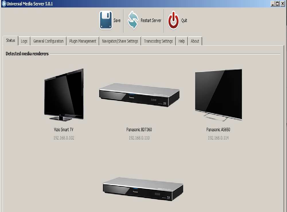

autodetection wrong
feb 10 2015 master
ip address
192.168.0.102 real is bdt360 comes up with viso and bdt360
192.168.0.110 real is panasonic as650 comes up bdt360 should comeup as nicktv and panasonic as650
192.168.0.114 real is panasonic as650 come up as DANtv and panasonic as650 working correctly

not sure why bdt comes up as viso tv address.102
why may as650 comes up as bdt address .110
there is 2 tv online as as650

The BDT360 is identifying itself to us using the same string as Vizio TVs use, so we are detecting it as that at first. Then it is sending info unique to itself afterwards so we detect it as BDT360.
The logs for the newer version look better than before so what is the issue? One of the TV isn't being detected?

the bdt at 192.168.0.110 is really the second panasonic as650SubJunk wrote:The BDT360 is identifying itself to us using the same string as Vizio TVs use, so we are detecting it as that at first. Then it is sending info unique to itself afterwards so we detect it as BDT360.
there is 2 panasonic as650 1 at 192.168.0.110 and 1 at 192.168.0.114
i wonder if the reqistration number is killing it
the bdt and viso at 192.168.0.102 is really bdt360
number of renders online is 3
2 as650 and 1 bdt
i need to hook up the other 3 units to really confuse you
Re: you been working on the pannasonic renders i would like you to fix this
I deleted both the panasonic as650 and the bdt it then change over to the 2 panasonic conf and 1 visio came up
took the bdt off line unplug it and it just panasonic. I wonder if my bdt has a issue it shows up when it turn off
problem is the bdt using the registration number for the second panasonic
