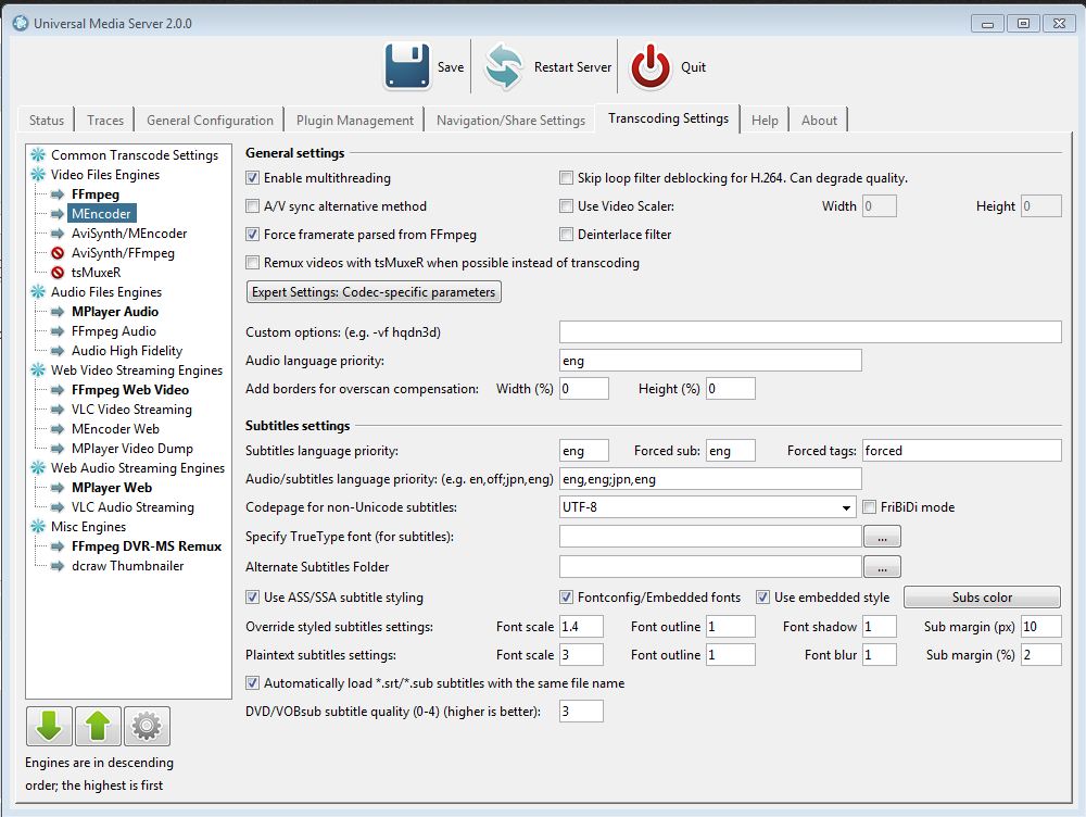

Hey,
I've been having an issue with MEncoder where the source is a very high quality MKV file and the output to the PS3 or media player from UMS is very blocky.
If I play the same file with a priority on FFmpeg the file plays flawlessly but without subtitles.
I'm trying to get the best of both worlds with flawless quality and subtitles. If this isn't possible ATM, at least that will keep me from pulling my hair out.

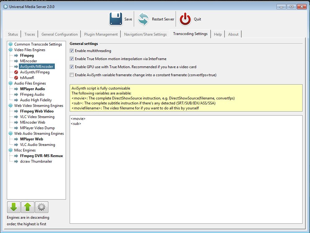

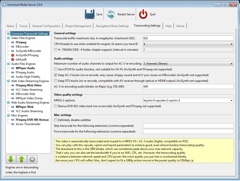

I've attached a few shots of my overall settings and can attach a log if needed..
- avime.JPG (112.33 KiB) Viewed 19782 times
- mencoder.JPG (140.07 KiB) Viewed 19782 times
- transcode.JPG (170.4 KiB) Viewed 19782 times

Hi GuardianX,
The easiest way to fix the problem is probably to reset your config file, which can be done by going to C:/ProgramData/UMS and renaming UMS.conf to something else (like UMS1.conf) then re-installing UMS.
If that doesn't work, logs would be useful, please reproduce the problem then go to the Traces tab and click "Pack debug files", and attach the generated zip file here.

Well to be honest, the native files won't be of much use to you because in order to get the file playing at all I had to heavily modify settings.
Here is a clean install run of the file..
I'll create a new post with the debug of what I am working with that has NEARLY what I want after this one.

This is what I am currently working with as well as a fresh log.
Video is processed using MEncoder 1st (since FFmpeg doesn't do subs)
Video is blocky
audio is timed well
Subs are timed well
File plays with no log visible errors.
Video is blocky
audio is timed well
Subs are timed well

The only reason I can see for blocky output would be that your TV isn't upscaling it; if you have an HD TV then this source video (which is only 720x480) may not have enough pixels to look good on the TV.
If you want to test the quality of the file being sent to the TV, you can open CMD, go to a new folder (like C:/a/ or something) and run the following command, which is taken straight from your last log:
That will create a file that is exactly what UMS is sending.

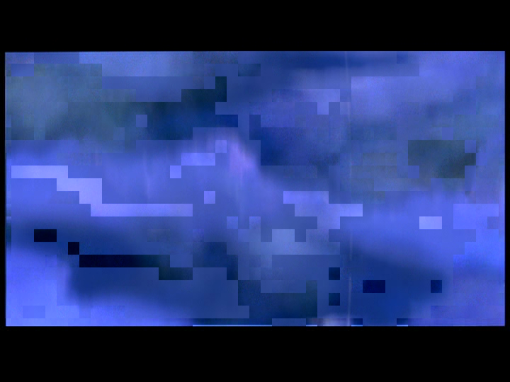

This is what running it as you said produced.SubJunk wrote:The only reason I can see for blocky output would be that your TV isn't upscaling it; if you have an HD TV then this source video (which is only 720x480) may not have enough pixels to look good on the TV.
That will create a file that is exactly what UMS is sending.Code: Select all
"C:\Program Files (x86)\Universal Media Server\win32\mencoder.exe" -ss 0 "C:\Users\GuardianX\Videos\Dvd backups\NEEDS RENAMED\Shrek.mkv" -msglevel statusline=2 -oac copy -of mpeg -mpegopts format=mpeg2:muxrate=500000:vbuf_size=1194:abuf_size=64 -ovc lavc -channels 6 -lavdopts debug=0:threads=8 -lavcopts autoaspect=1:vcodec=mpeg2video:acodec=ac3:abitrate=640:threads=8:keyint=5:vqscale=1:vqmin=1:vrc_maxrate=274000:vrc_buf_size=1835 -font C:\Windows\Fonts\Arial.ttf -subfont-text-scale 3 -subfont-outline 1 -subfont-blur 1 -subpos 98 -fontconfig -spuaa 3 -sid 0 -ofps 24000/1001 -lavdopts fast -mc 0 -noskip -o file.mpeg
Thanks for the comments and concern, I've been burned out on work in the past so hopefully I can spot it happening before it gets bad now, I do a lot of recreation to balance it out too

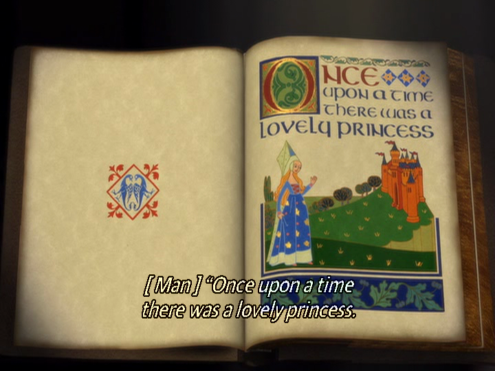

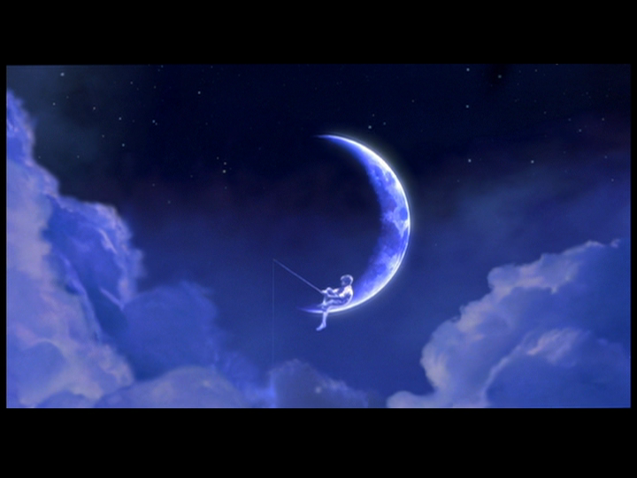

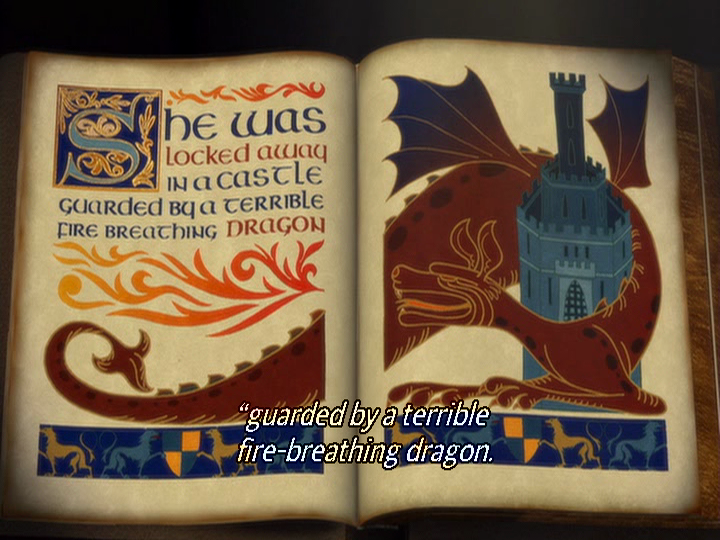

Here is what the native file looks like when played directly in VLC.
the shots are not the same scene but the general opening.
Also it should be said, and I'm not sure if this makes a difference but, the output file from the command you gave me was almost 2x the file size of the original file and I'm not sure if it finished the file.

Interesting, looks like a MEncoder bug.
Can you try this one?
And maybe this one too:
"C:\Program Files (x86)\Universal Media Server\win32\mencoder.exe" -ss 0 "C:\Users\GuardianX\Videos\Dvd backups\NEEDS RENAMED\Shrek.mkv" -oac copy -of mpeg -mpegopts format=mpeg2:muxrate=500000:vbuf_size=1194:abuf_size=64 -ovc lavc -channels 6 -lavcopts autoaspect=1:vcodec=mpeg2video:acodec=ac3:abitrate=640:keyint=5:vqscale=1:vqmin=2:vrc_maxrate=54000:vrc_buf_size=1835 -sid 0 -ofps 24000/1001 -mc 0 -noskip -o file.mpeg
"C:\Program Files (x86)\Universal Media Server\win32\mencoder.exe" -ss 0 "C:\Users\GuardianX\Videos\Dvd backups\NEEDS RENAMED\Shrek.mkv" -oac copy -of mpeg -mpegopts format=mpeg2:muxrate=500000:vbuf_size=1194:abuf_size=64 -ovc lavc -channels 6 -lavcopts autoaspect=1:vcodec=mpeg2video:acodec=ac3:abitrate=640:keyint=5:vqscale=1:vqmin=2:vrc_maxrate=54000:vrc_buf_size=1835 -sid 0 -ofps 24000/1001 -o file.mpeg

Outcome:SubJunk wrote:Interesting, looks like a MEncoder bug.
Slight FPS jitter not sure if it comes from playing the file mid stream.
-Quality seems good
-Audio is synced
-Subs are present
SubJunk wrote: And maybe this one too:
Outcome:
Same FPS jitter
-Quality seems good
-Audio is delayed
-Subs are present
I ended up killing the process because it was spamming with "Skipping frame!"
Re: Issue with MEncoder
In reply to the jitter, it was me being stupid and not seeing the "keyframe" variable set to 5 from when I had it at 1.
Readjusted there isn't an issue.
"C:\Program Files (x86)\Universal Media Server\win32\mencoder.exe" -ss 0 "H:\Entertainment\Movies\Shrek.mkv" -oac copy -of mpeg -mpegopts format=mpeg2:muxrate=500000:vbuf_size=1194:abuf_size=64 -ovc lavc -channels 6 -lavcopts autoaspect=1:vcodec=mpeg2video:acodec=ac3:abitrate=640:keyint=1:vqscale=1:vqmin=1:vrc_maxrate=54000:vrc_buf_size=1835 -sid 0 -ofps 24000/1001 -mc 0 -noskip -o file.mpeg
