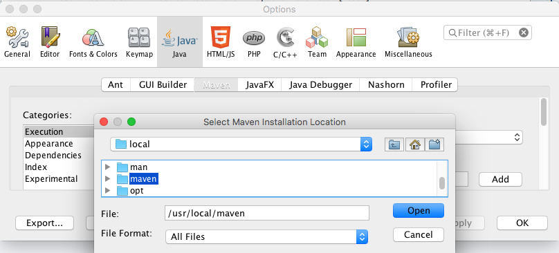

Yup - "mvn -v" reports the latest v3.3.1 but NB still fails.
Murphy is still around: after my previous post I continued the search through the OSX-NB-maven posts.
Finally I hit the "right" one: NB configuration
NB > Preferences(Options) > Java > Maven > Maven Home: Browse <select> < Open > Apply > OK
That's it. It worked!
Screen Shot 2017-01-02 at 10.45.07 PM.png (73.97 KiB) Viewed 69293 times
I chose to use a symlink pointing to it:
$ sudo ln -s apache-maven-3.3.1 /usr/local/maven
$ ls -l /usr/local/maven
lrwxr-xr-x  1 root  wheel  18 Jan  2 19:56 /usr/local/maven -> apache-maven-3.3.1
It allows updating or regressing by just changing the link and not the NB Preferences, done in the terminal (iTerm) ksh .profile script as a new window is opened.
